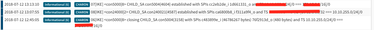

          Why is your subnet /24/0?!
          Do not know the reason why is it like that in system logs. On the configuration side only mask /24 was in use.
          Evan when established the log is the same regarding subnet notation.
          Thanks for the help!
