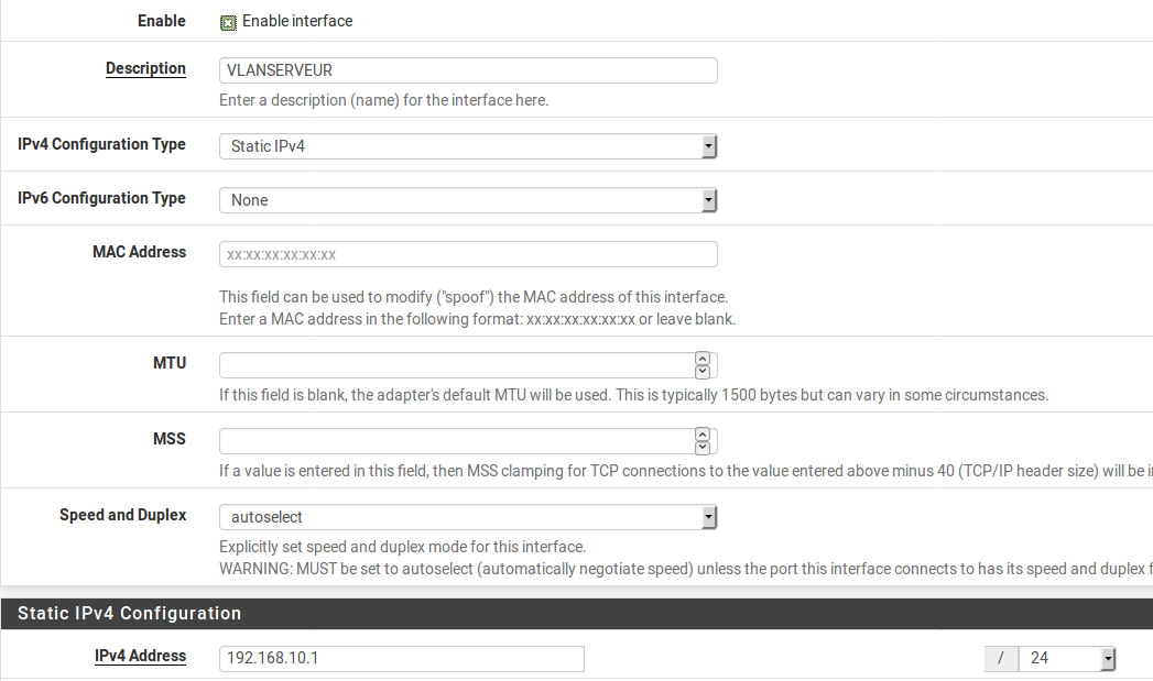

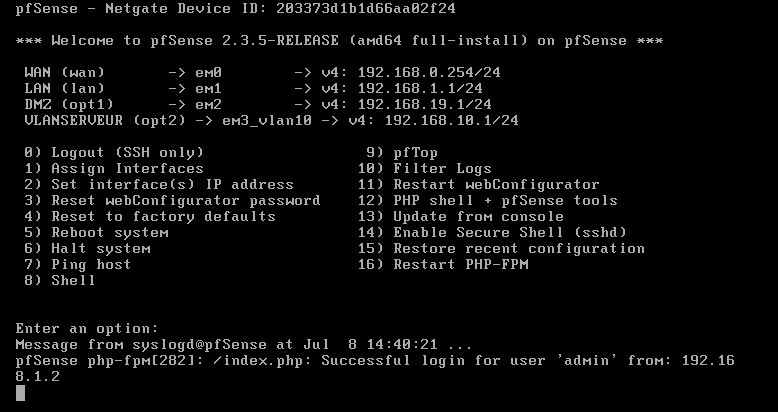

      Here are my interfaces :
      Here the configuration of this VLAN :

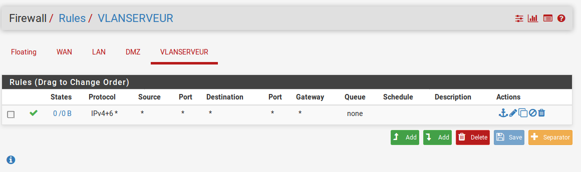

      And here the firewall rules :
      My LAN can access internet.

              Note the firewall rule in the image you posted has 0B received. That indicates it is receiving no traffic.
