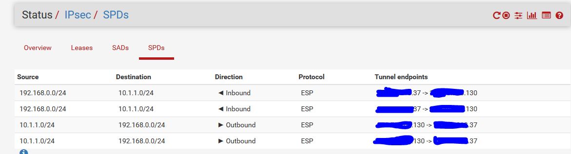

Tunnel between the two was MUCH easier to establish, but now I can't get any traffic to move over it (no ping).
One odd thing to me is that packet capture shows ping leaving WAN interface, instead of ipsec interface.
By the way, not sure why there are duplicate SPDs.

SPDs:
"src 192.168.0.0/24 dst 10.1.1.0/24 proto 17 dir out priority 375167 tmpl src xx.xx.xx.37 dst yy.yy.yy.130 proto esp spi 0xcf0e7bb3 reqid 7 mode tunnel src 10.1.1.0/24 dst 192.168.0.0/24 proto 17 dir fwd priority 375167 tmpl src yy.yy.yy.130 dst xx.xx.xx.37 proto esp reqid 7 mode tunnel src 10.1.1.0/24 dst 192.168.0.0/24 proto 17 dir in priority 375167 tmpl src yy.yy.yy.130 dst xx.xx.xx.37 proto esp reqid 7 mode tunnel" "src xx.xx.xx.37 dst yy.yy.yy.130 proto esp spi 0xcf0e7bb3 reqid 7 mode tunnel replay-window 0 flag af-unspec auth-trunc hmac(md5) 0x9556afb101bf2619229173f0dfa17a38 96 enc cbc(aes) 0xb1c0cc12fa2f2ee6417a410aa5b04ca2 anti-replay context: seq 0x0, oseq 0x0, bitmap 0x00000000 src yy.yy.yy.130 dst xx.xx.xx.37 proto esp spi 0xc51d4c3a reqid 7 mode tunnel replay-window 32 flag af-unspec auth-trunc hmac(md5) 0x5d055d62880f2f086755883b9ff6a247 96 enc cbc(aes) 0x7c56d223f52691b85d19a918d18c564f anti-replay context: seq 0x0, oseq 0x0, bitmap 0x00000000"
