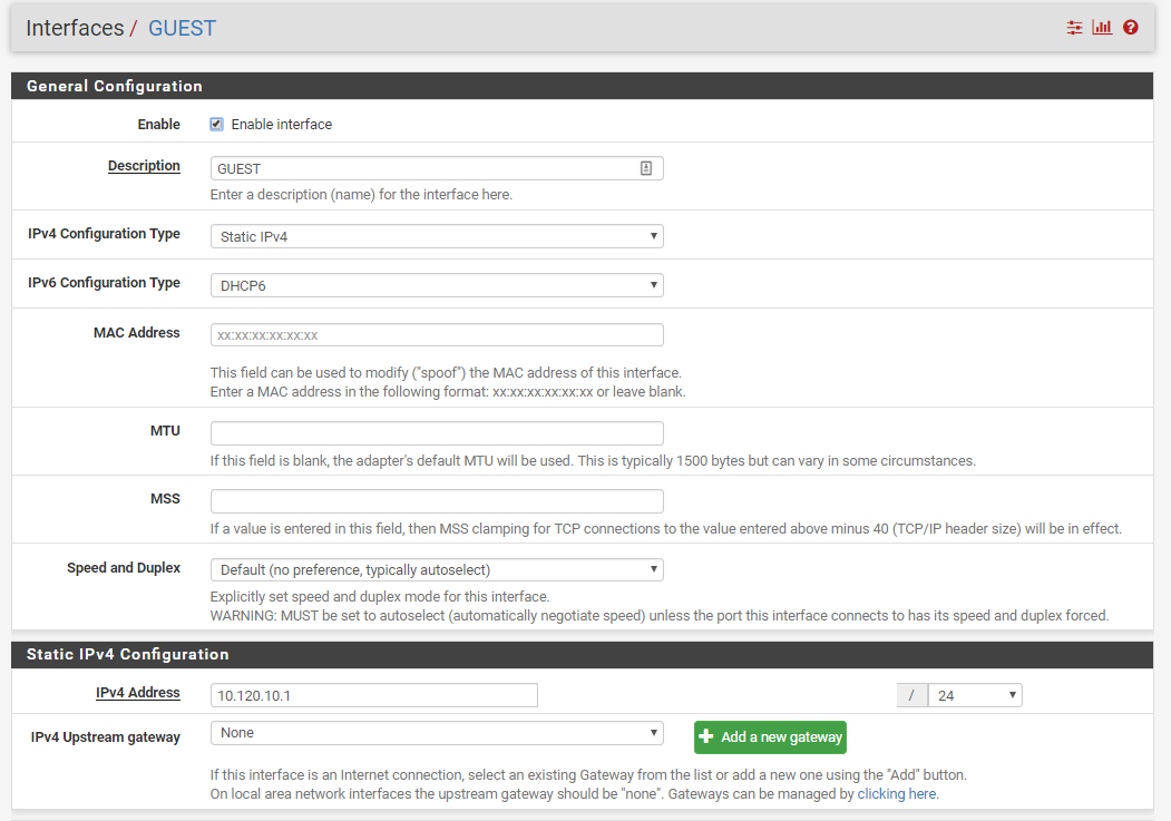

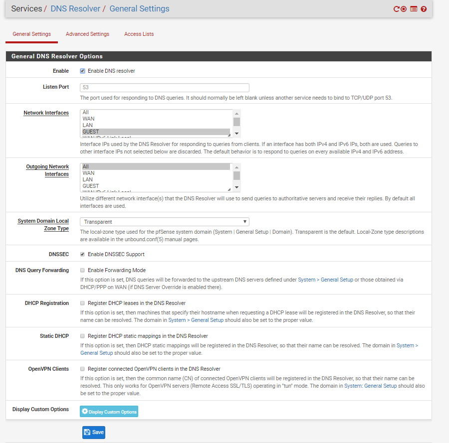

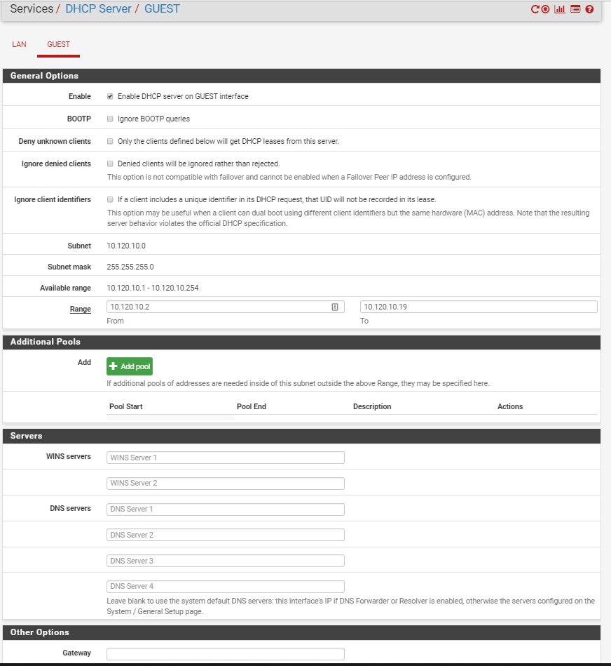

        Here's some snips that might help:
        Interface setup
        DHCP
        DNS
