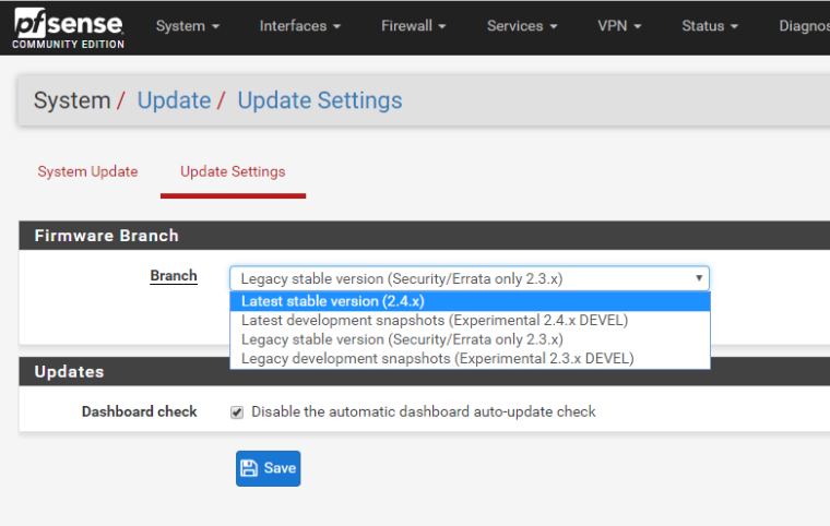

        Just set the right Branch:
          alivdel @Bismarck
          @bismarck thanks for reply
          thats my Problem because it Shows only 2.3.x, there is no Version 2.4.x.
