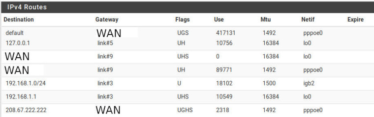

  • Here my main routes, to me it looks good. I cut out some openvpn lines, it's not running anyway. LAN is 192.168.1.0.
    workstation route:
    192.168.1.0 * 255.255.255.0 U 0 0 0 br0
    ISP IPv6: I think IPv6 is supported, but the current WAN is IPv4.
