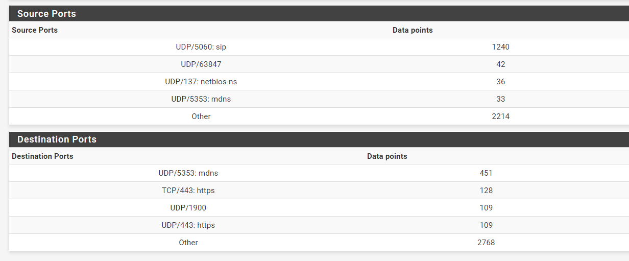

                        Just to give us an idea post a screenshot of the bottom of Status -> System Logs -> Firewall -> Summary View.
                        Here's mine I only have 3000 ish drops in total.

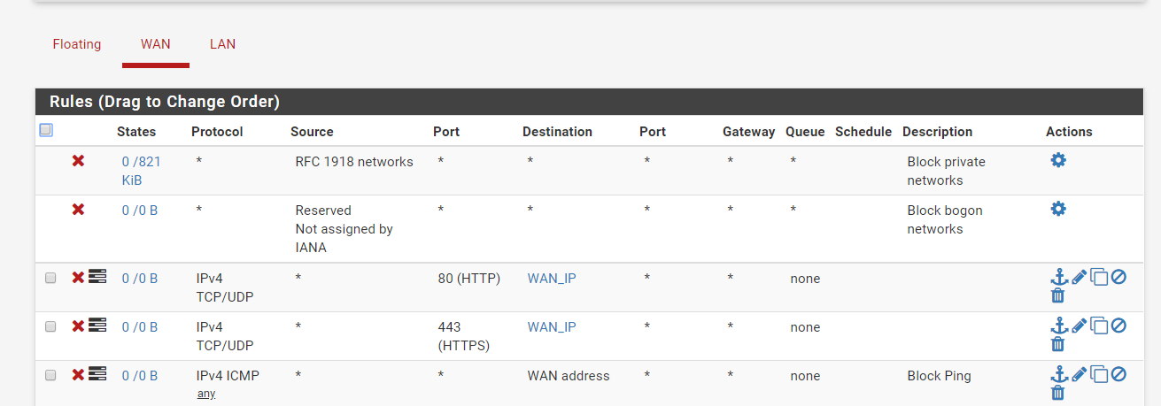

                                            Derelict LAYER 8 Netgate
                                            You said they WERE closed.
                                            Post your WAN rules.
