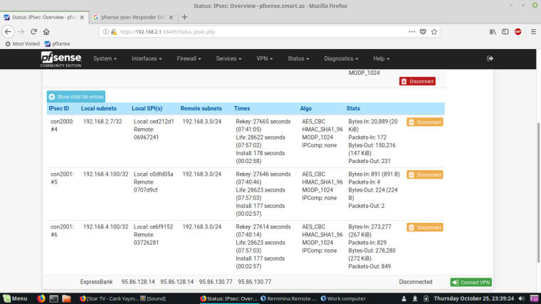

      1. We have IPSec IKEv1 connection between head office and branch office. Head office has pfSense and branch office has MIkrotik Routerboard. Both has the same configurations. Phase 1 is working normal, but sometimes phase 2 becomes multiple which are the same though phase 2 lifetime hasn't expired, it creates new one.

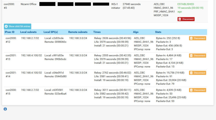

      2. When ipsec connects, there is 15 minutes difference between rekey and lifetime in phase 2. When Phase 1 lifetime is 86400 and phase lifetime is 28800 on both sides another new phase 2 is being created automatically by pfsense 1 hour 10 minutes before the current phase 2 rekey expires, however current rekey hasn't expired.
      I reduced lifetime on both sides, phase 1 28800 and phase 2 3600, but it didn't change the result. I noticed that it happens when there is more than one phase 2.
      I am pasting logs here for your review.

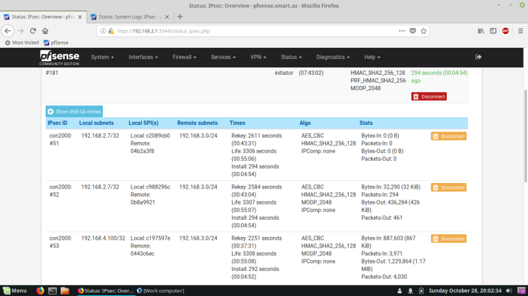

        3. Today I created IKEv2 with another branch. First times it worked okay, when phase 2 rekey expires, it created automatically new phase 2 and deleted the old one. It worked okay until then, when phase 1 lifetime expired, it created new phase 1 and deleted old phase 1, but it recreated the same phase 2s, however phase 2s rekey hasn't expired. But in IKEv1 when phase 1 expires, it creates new phase 1, but doesn't create phase 2 which ones rekey has not expired.
        I like pfSense, but this issues tires me. I am pasting the logs of ipsec with IKEv2 for your review.

            I switched from IKEv2 to IKEv1, but when ipsec connects there double the same phase 2.

            • DerelictD
              Derelict LAYER 8 Netgate
              But does it impact traffic flow across the VPN?
              Chattanooga, Tennessee, USA
              1 Reply Last reply
              Reply Quote 0
              • emammadovE
                emammadov
                I ping remote server, it is going okay, sometimes it shows "Request timed out". As you can see it duplicates phase 2.
                Elvin
                1 Reply Last reply
                Reply Quote 0
                • DerelictD
                  Those are harmless. They are rekeyed tunnels. They are not the cause of any traffic flow issues. They will disappear when their lifetimes expire. They are there in case the other side sends traffic to the rekeyed SAs so it can be decrypted.
                  Running the shell command ipsec statusall will reveal them as rekeyed.
                  If you have traffic problems over the VPN I would not spend any more time on that and focus on other reasons you might be seeing what you are seeing.
                  1 Reply Last reply
                  Reply Quote 0
                  • emammadovE
                    emammadov
                    Thank you. The problem is, when phase 2 rekey expires it creates a new one, but it also duplicates phase 2. Then there are two same phase 2, they expire and create new same ones.I have 4 ipsec connections, one with Palo Alto, the rest with Mikrotik routers. Ipsec with Palo Alto and one of Mikrotik is working normal. Though the rest two Mikrotik have the same configurations as others, we see these issues.
                    You think it is because of Mikrotik?
                    What if I disable rekey? Then it will not work?
                    Why there are 15 minutes difference between rekey and life?
                    Is it okay if I add margin time for example 5 seconds, because of decreasing 15 minutes to 5 seconds?
                    Why phase1 in IKEv2 expires, it removes all phase 2 and creates phase 2 again? This doesn't happen in IKEv1.
                    Elvin
                    1 Reply Last reply
                    Reply Quote 0
                    • DerelictD
                      @emammadov said in IPSec issues:
                      Right. That is normal.
                      No.
                      No. I would not do that.
                      The rekey is set randomly a short interval before the lifetime. This is perfectly normal.
                      I would leave it alone.
                      Because that's how it works. You can see if enabling Make-Before-Break in VPN > IPsec, Advanced helps but read the notes there and understand that will affect all IKEv2 tunnels.
                      Keep in mind that the IPsec > Status screen can be delayed by several seconds.
                      Again, those rekeyed SAs are probably NOT the source of any problems you are having as long as the new SA is established on rekey. You are probably chasing a ghost. 👻
