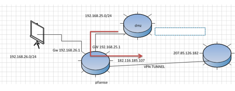

  • Hello, I have a network as seen in the graph, where it is at first only had the network 192.168.25.0 connects to my Pfsense and is one to a VPN Tunnel through IPSec to another network, the problem that I now have is I have another segment of red 192.168.26.0 and I also want this pass through the tunnel, but you can not because the VPN only negotiates with IPs of the red 192.168.25.0, how can I solve it?
    Note: within the policies on the other side of the tunnel only one segment of the tunnel is included so it is not possible to add the red 192.168.26.0.
    Can anybody help me?

  • @derelict said the other side to TUNNEL is 192.168.1.0/24 network, need connect to devices to 192.168.26.0/24 internal network to TUNNEL but only accept devices to 192.168.25.0/24 configured into TUNNEL, noted the other side to TUNNEL only accept one network for politic to the company. do not add to other subnetwork

    What traffic selectors does the other side expect to see?
    Local 192.168.1.0/24 <-> 192.168.25.0/24 Remote ???
    What traffic selectors do you expect to see?
    Local 192.168.26.0/24 <-> 192.168.1.0/24 Remote ???
    Or both:
    Local 192.168.25.0/24 <-> 192.168.1.0/24 Remote
    If the former, it's easy. If the latter you can't do that without changes to the other side.
    pfSense will not NAT a larger network to a smaller pool of addresses. You can BINAT 1:1 or NAT to a single address. Natting to a single address would also require they change their tunnel to that /32.
  • @derelict
    expect traffic.
    is functionally
    Local 192.168.26.0/24<->TO REPRESENTATIVE IP 192.168.25.0/24 <-> 192.168.1.0/24 Remote
  • LAYER 8 Netgate
    Phase 2:
    Local Network: Network 192.168.26.0 /24
    NAT: Network 192.168.25.0 /24
    Remote Network: Network 192.168.1.0 /24
    And you're done.
    Connections from, say, 192.168.26.191 to 192.168.1.0/24 will appear to them to come from 192.168.25.191
    Connections from them to 192.168.25.195 will arrive on 192.168.26.195 on your side.
    They should establish one traffic selector for traffic:
  • Oh!!! Genius... Thank you... Problem solved.
