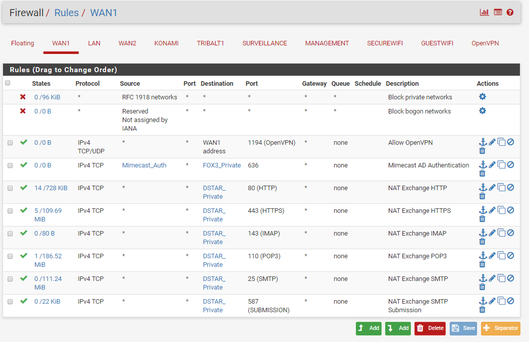

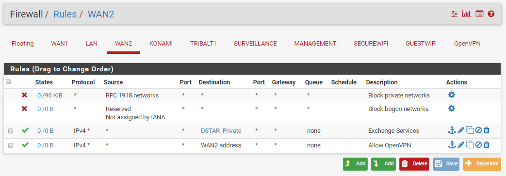

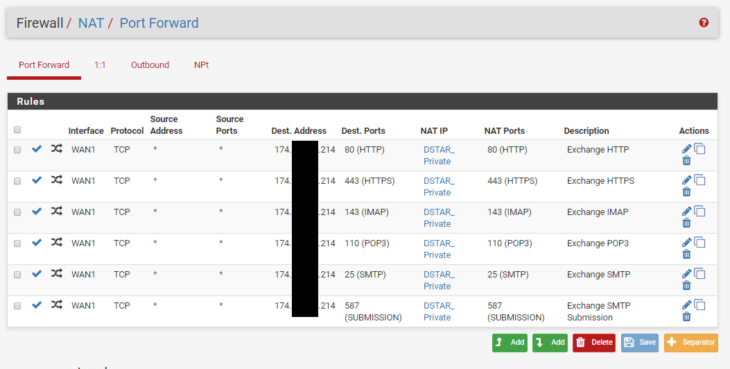

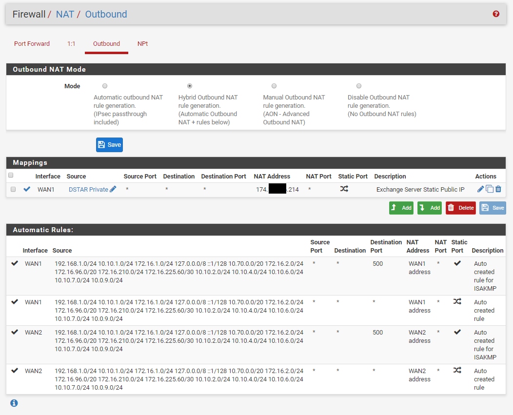

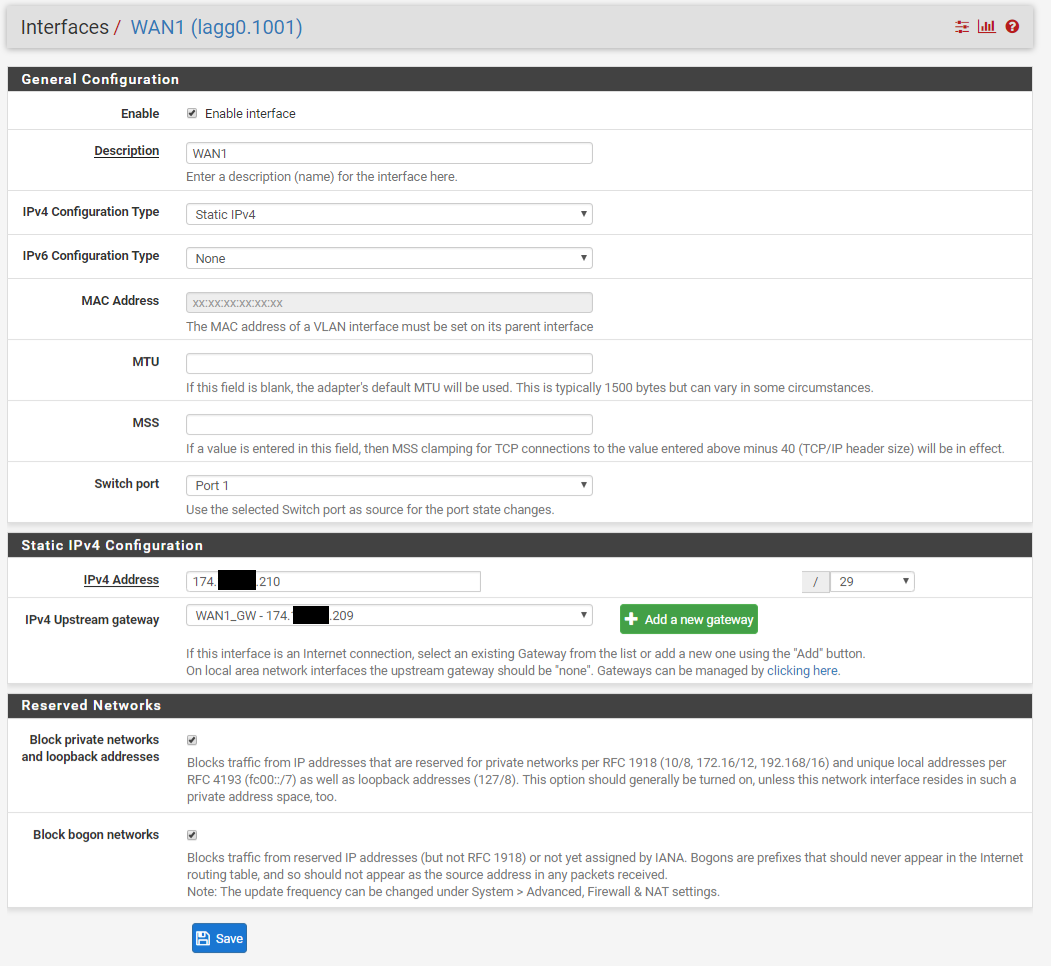

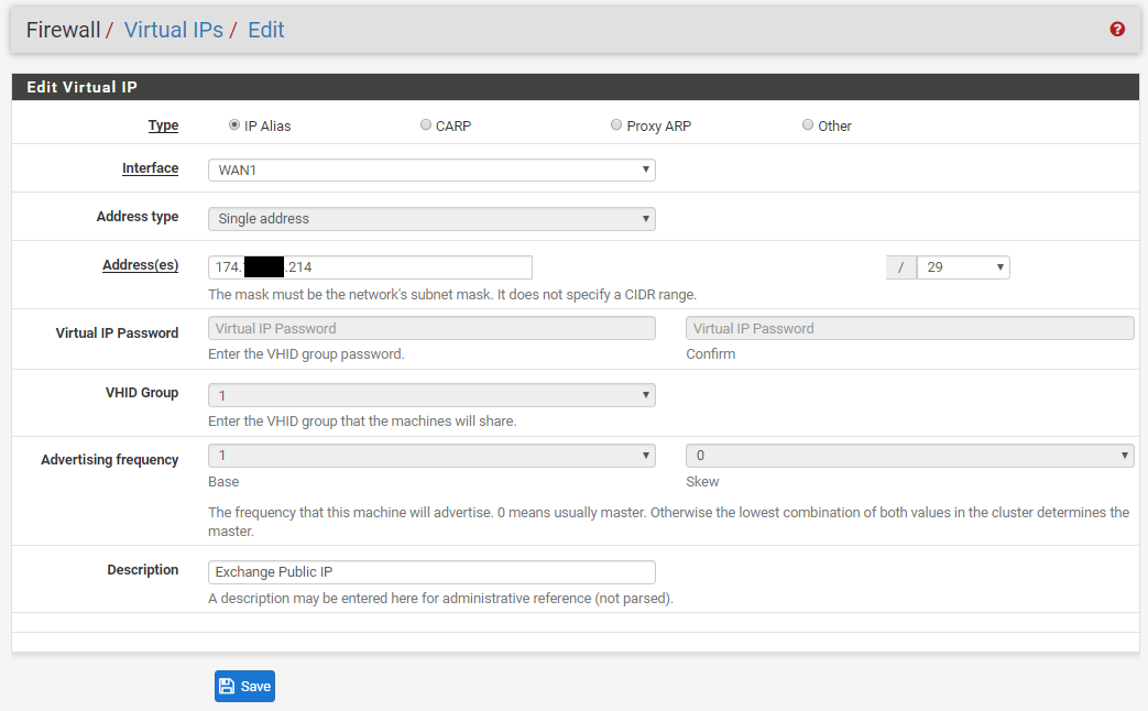

      We have two ISP connections. WAN1 (Static /29 CIDR Block) and WAN2 (DHCP). We have port forwarding setup for an Exchange server using a Virtual IP address within the /29 CIDR block of WAN1. We also have Outbound NAT for this same Exchange server to always use that Virtual IP address.

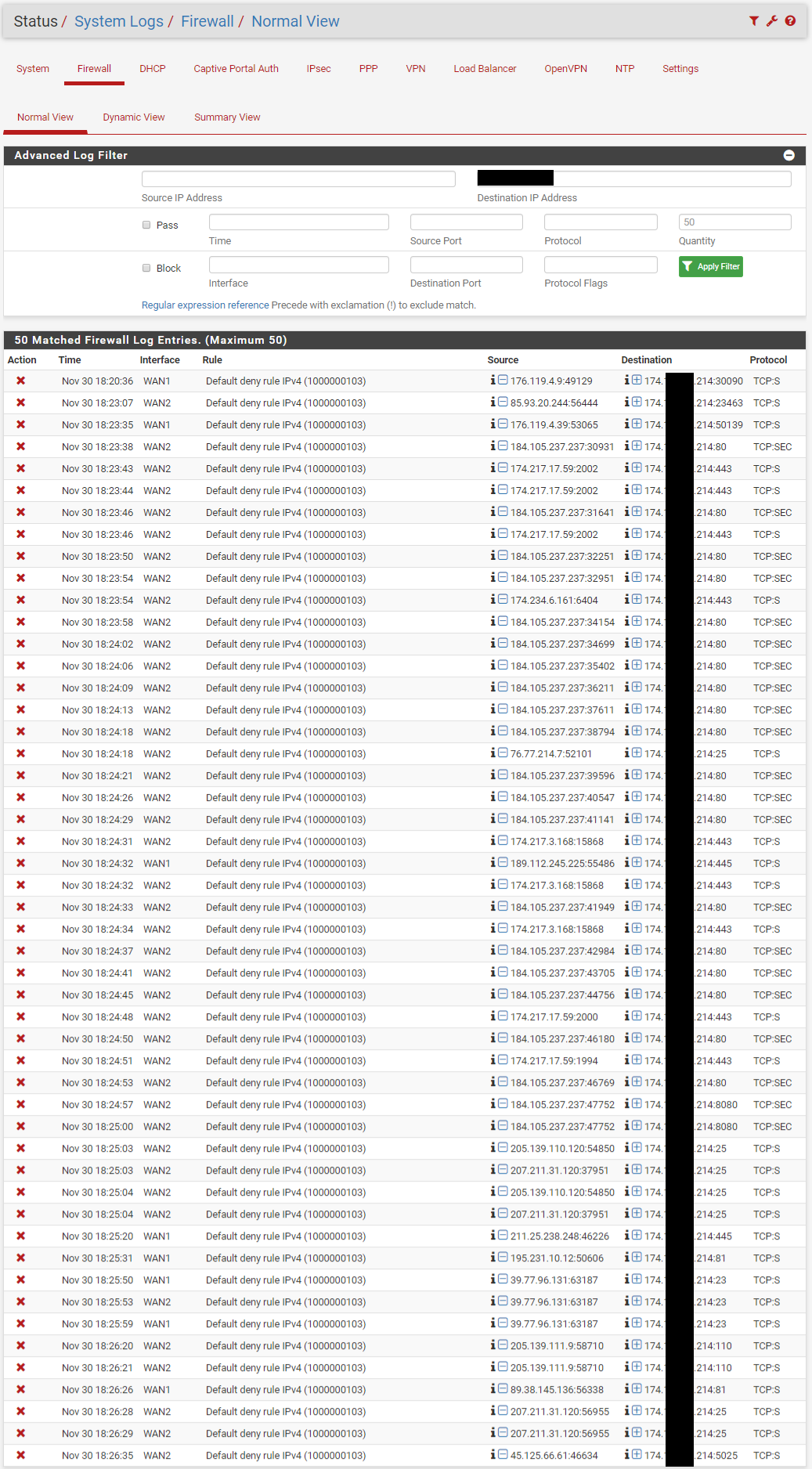

      As soon as the WAN2 interface is turned on, port forwarding intermittently works. Some traffic gets through and some is blocked. Reviewing the Firewall Logs, the blocked traffic is showing as originating from the WAN2 interface, though it obviously came in on the WAN1 interface due to the destination IP address.
      We do also have NAT Reflection turned on if that is of any interest.
      What would make incoming traffic from WAN1 show as originating from WAN2 in the firewall logs?

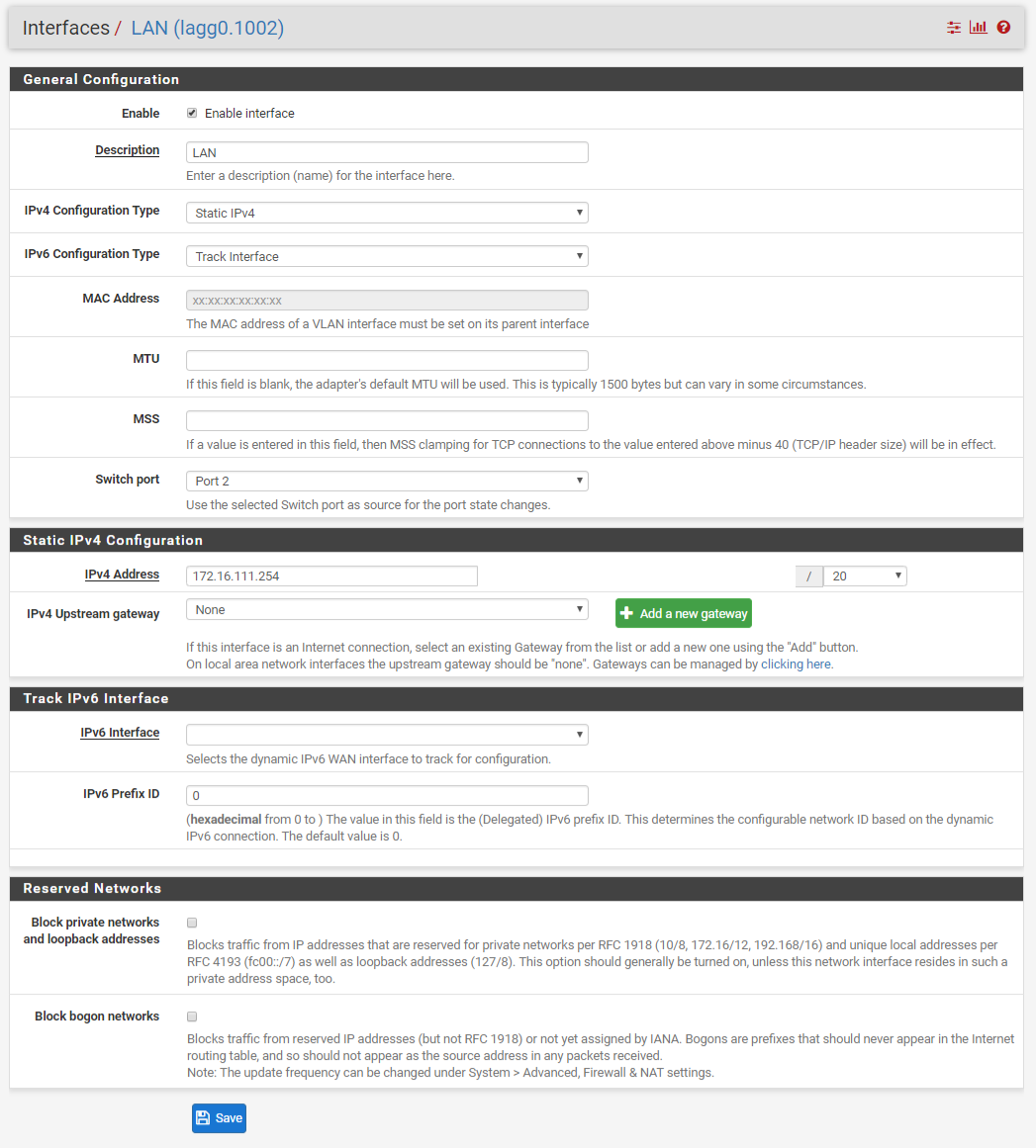

      0_1543604342619_Interface LAN.png 0_1543604347550_Interface WAN1.png 0_1543604351457_Interface WAN2.png 0_1543604358564_Virtual IP Exchange Public.png 0_1543604365853_Port Forwards.png 0_1543604369060_Outbound NAT.png 0_1543604377527_Firewall Rules WAN1.png 0_1543604381032_Firewall Rules WAN2.png 0_1543604384018_Firewall Log.png

        Looks like your ISP is sending you traffic for 174.X.X.214 on WAN2 when it's up.
        Why is that?
        All of the blocks shown for WAN1 look like ports that have not been forwarded/passed and should be blocked.
        Should probably also show your switch configuration just to be sure that's all correct.

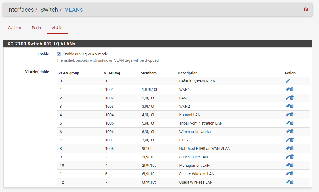

          WAN2 is also on a completely different IP range. It seems like the rerouting of traffic is happening within the Netgate router, just not sure what is causing it. Attached are the switch configuration pages.

                Like I said, you need to get with them to see why they are sending that traffic to the wrong WAN. Are you sure it's supposed to be two connections and not one with a routed subnet? Two WANs from one provider over one fiber doesn't make any sense to me from a redundancy point-of-view.
