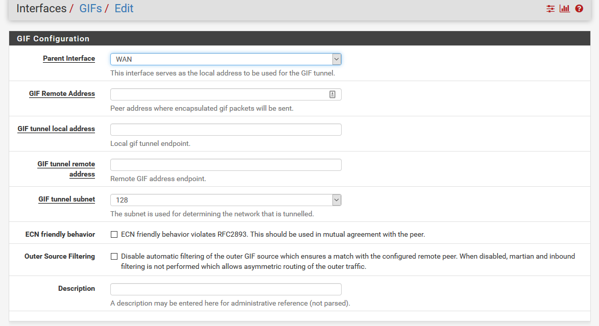

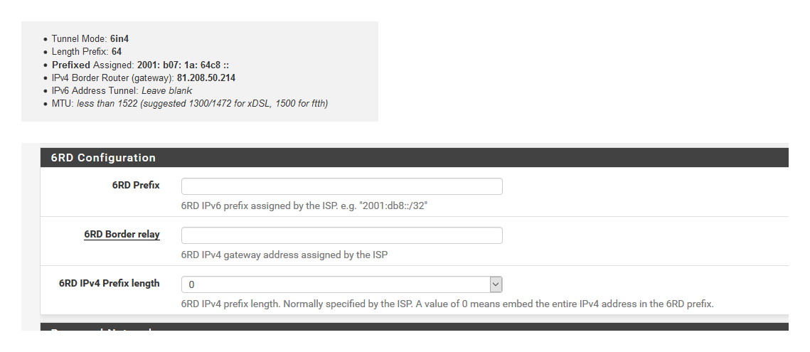

      mikekoke @johnpoz
      @johnpoz These are the basic settings that Fastweb provides to all users.
      That IP is provided to everyone for the tunnel.
      81.208.50.214( It is supplied for northern Italy )
      2001:b07:51d0:32d6::
        I suggest you contact your ISP for clarification because you don't create a local IP in your tunnel and a remote IP in your tunnel that are not in the same prefix.. And you sure and hell would not use the same prefix on your tunnel as you do on your LAN side, etc..
        Do you have a link to these instructions?
          mikekoke @johnpoz
          @johnpoz
          Generic Guide: https://www.fastweb.it/forum/ipv6-f24/tunnel-6in4-per-router-aggiuntivo-t9985.html
          My topic: https://www.fastweb.it/forum/ipv6-f24/ipv6-6rd-su-pfsense-t25182.html
            Says they
            Fastweb offers the service through Tunnel 6rd in DHCP Option 212 configuration (ie all the tunnel data arrive via DHCP)
            You can set your wan to 6rd..
            But not sure how you think you can convert the info they give to a GIF configuration?
              mikekoke @johnpoz
              @johnpoz I do not understand what you mean ?
              So could I create a 6Rd tunnel even though pfsense has a private ip as a WAN address?
                NO.. Get with your ISP... The info in that link is for a 6rd tunnel - you can not just convert that to the settings you put into a gif tunnel.
                  mikekoke @johnpoz
                  @johnpoz I understand.
                  In fact, to avoid mistakes I asked for advice on that forum and they gave me that configuration for 6in4 which is ultimately wrong.
                    Where did they give you that - in your link to your thread... They DID not give you any info for GIF..
                    That guy was giving you some example from his network - you would have to pull the info from your own settings.
                    CALL YOUR ISP!!! Have them give you the ADDRESSES to use for your GIF and what network to put on your LAN - not try and translate stuff from your 6rd info.. Which you could prob pull out the addresses when you setup 6rd... But you can not put prefixes into your ADDRESS spots on your GIF..

                      mikekoke @johnpoz
                      @johnpoz Request sent now.
                      That boy did not seem to have meant that configuration as an example.
                      Thanks again for the clarification.
