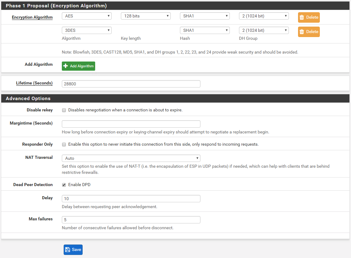

      then the configuration of pfSense is

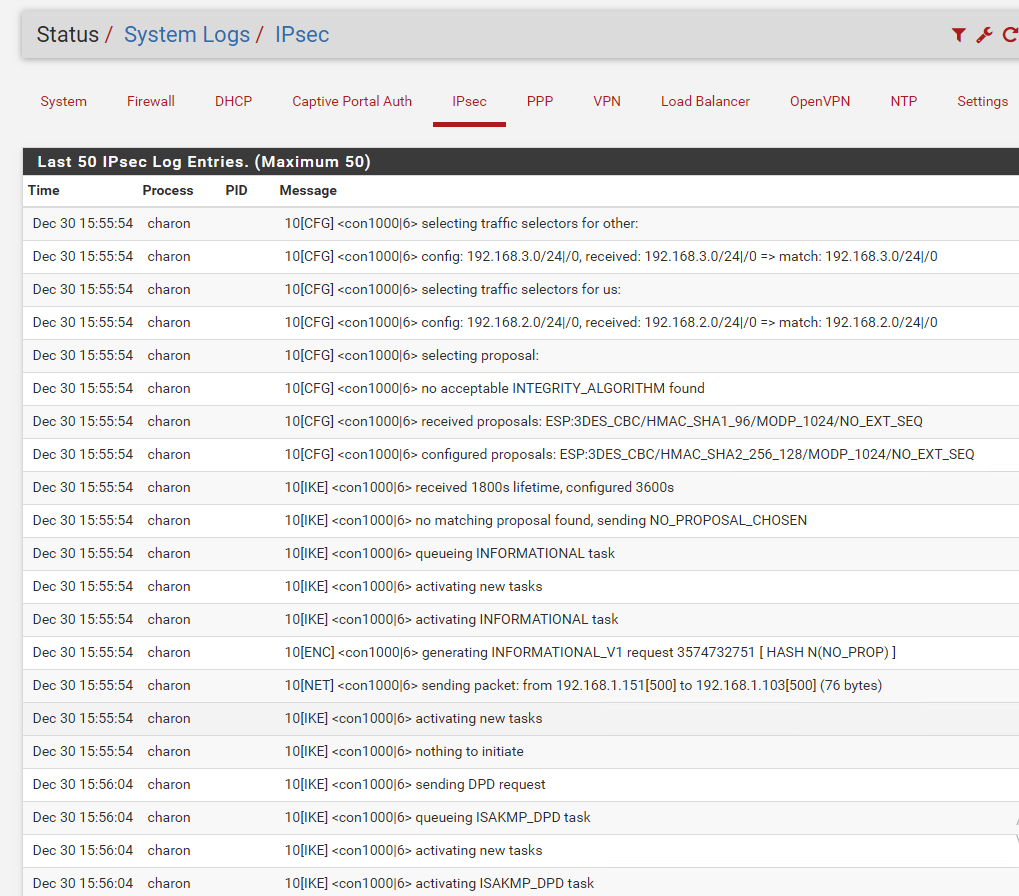

      And the log of pfSense

        Hey
        change in the settings of microtic hash algorithm sha1 to sha256 or in the settings of pfsense change sha256 to sha1 (phase 2 setting)
        here is a mistake

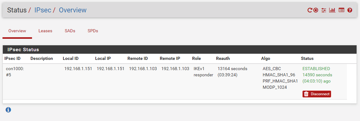

          Hi!! Thanks so much !! now the tunnel is stablished I change in the PfSense like you say and done

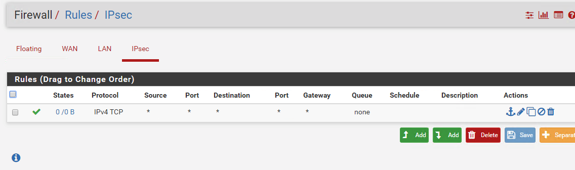

          But now I couldn´t test ping to host 192.168.2.1 LAN gateway from host with ip 192.168.3.2 why ? maybe I need to open port on firewall/rules ?

            @k15 tcp and icmp - protocols are different ))
            Change in IPSec rule protocol tcp to any

              @konstanti said in VPN between PfSense and Mikrotik IPsec no Phase2:
              Done !! now I can do ping, I will create folder to test sharing but if ping work work all.
