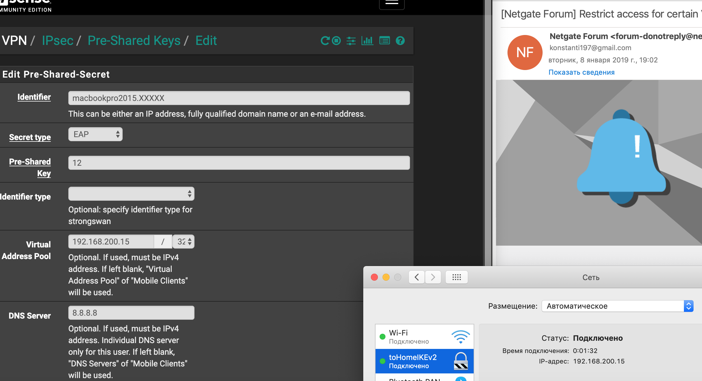

              Konstanti @luas
              @luas
              There is such an opportunity for Road Warriors
              What authentication method is used ?
              • L Offline
                luas
                We authenticate via Active Directory. "Pre-Shared Keys" as in your screenshot is empty in our pfsense config.
                K 2 Replies Last reply Reply Quote 0
                • K Offline
                  Konstanti @luas
                  @luas
                  It doesn't matter
                  You can fill in this field with any characters, as long as the user ID matches
                  This creates a config for the user "engineer" and assigns the required ip address

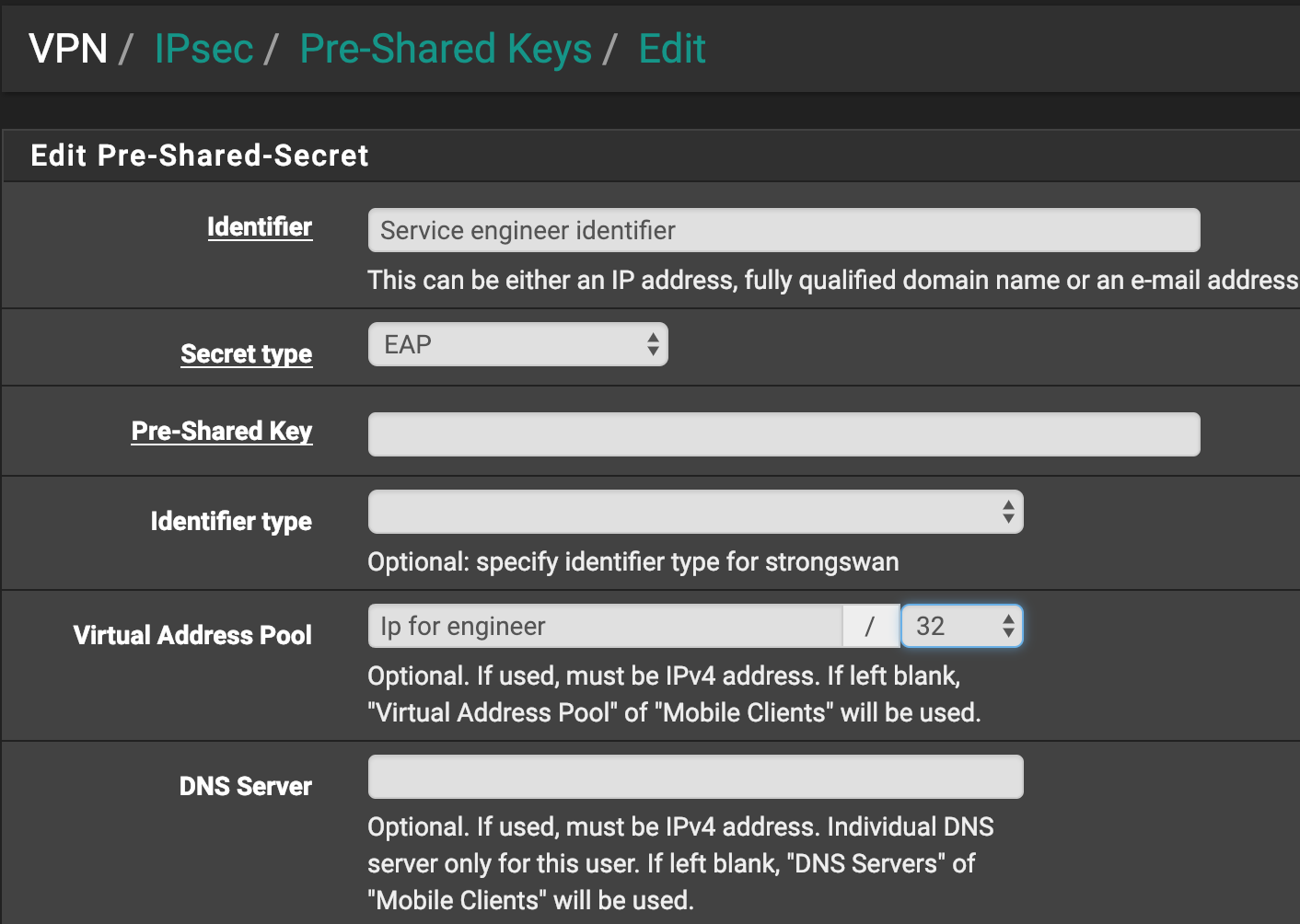

                  • K Offline
                    Konstanti @luas
                    @luas For example
                    I have authorization configured on the certificates
                    • L Offline
                      luas
                      @Konstanti Thanks!
                      I tried this, but with no luck.
                      I used "username" or "username@domain.local" as Identifier, entered a Pre-Shared-Key and a specific IP-Adress with mask /32.
                      But I will still get an address from the default pool.
                      I also tried to configure a unique PSK for the engineer in the given dialog, but then the tunnel won't come up at all.
                      Any other idea?

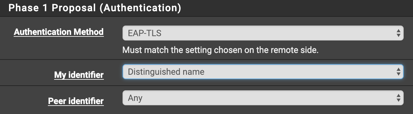

                      • K Offline
                        Konstanti @luas
                        @luas Hey
                        Show me how you filled in these fields
                        And what is the ID of the engineer ?

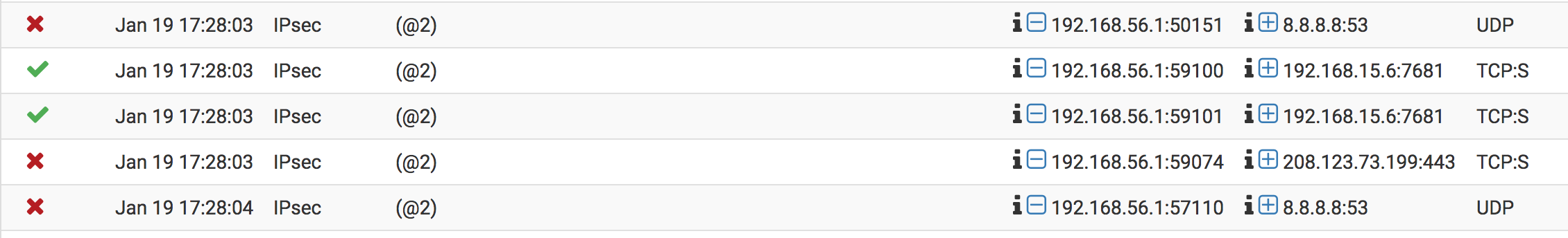

                              • K Offline
                                Konstanti @luas
                                @luas
                                t's easy , but you need to work with your hands a little .

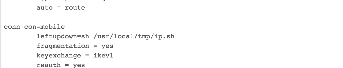

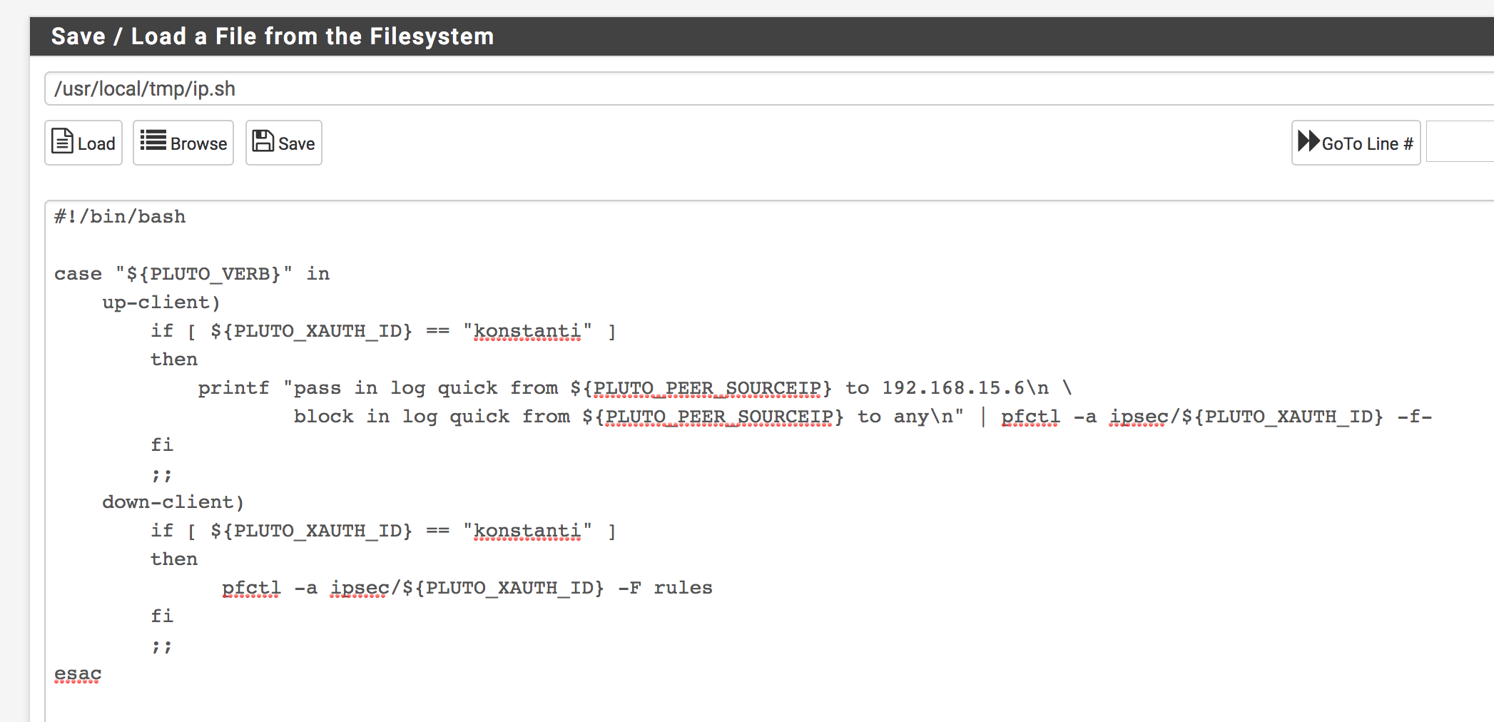

                                1. create a file on the firewall , for example, /usr/local/tmp/ip.sh
                                  make it executable, chmod +x ip.sh)
                                  Write on there such the text
                                Save

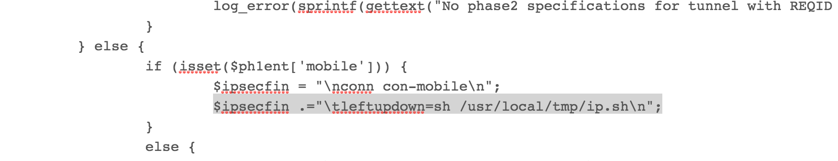

                                1. /diagnostics/edit file/ etc/inc/vpn.inc
                                  Find here is such a string
                                  if (isset($ph1ent['mobile')])) {
                                  Adding here is such the text
                                  $ipsecfin .="\tleftupdown=sh /usr/local/tmp/ip.sh\n";
                                Save
                                1. vpn/ipsec/ mobile client /phase 1/ not to change anything . Click Save, exit
                                2. /diagnostics/edit file /var/etc/ipsec.ipsec.conf
                                Make sure that everything is correct

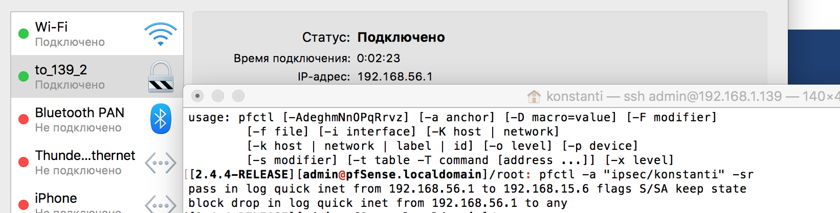

                                As a result at us at an input of the user "konstanti" the script which gives it the rights of connection only to a host 192.168.15.6 works , other traffic is blocked. No matter what virtual ip it gets.
                                Other users work without restrictions
                                In your case , we change the username to "engineer ID" and adjust the rules so that it has limited access.
                                This can be done for any user
                                The only caveat that we need to know .
                                With every system update , the file vpn.inc will be overwritten and changes will need to be made again
