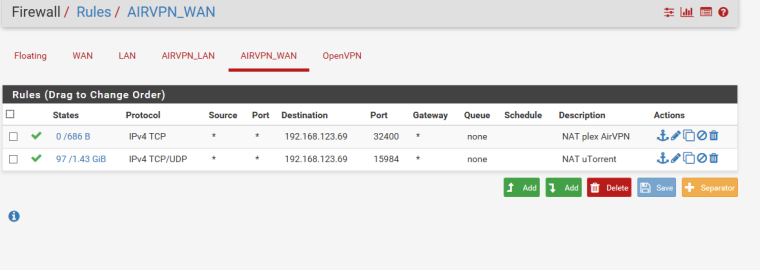

      hi, sorry i'm still learning pfsense
      I have 3 NIC cards (1 WAN) (1 LAN#1 ) and (1 LAN#2 - VPN)
      everything is working except both LANS cannot communicate with each other, I think I need a rule to allow for this but not sure
      LAN#1 - 192.168.1.0/24
      LAN#2 - 192.168.123.0/24
      from either LAN I can ping the other LANs gateway but no of the devices
      example: PC 192.168.1.100 can ping both 192.168.1.1 and 192.168.123.1 but not 192.168.123.100
      I have a plex server on 192.168.123.69 which is not seen as local/LAN but 192.168.1.0/24 network, they see it as a remote device.

              @johnpoz pfsense has to be blocking communication between subnets. I followed the airvpn guide and have OPT1 as AirVPN WAN and NIC3 as AirVPN LAN. NIC1 as WAN and NIC2 as regular LAN. I'm assuming there has to be a firewall rule or static route to allow both my LAN subnets to talk? because they are not able to ping or communicate right now.
              any help with the rules that would allow communication between to seperate subnets would greatly be appreciated
                If your forcing traffic out a gatway, ie your vpn - then how would it get to your other vlan?
                Post up your rules for your lan and vlan..
                You do not need a route for any network that is directly attached. But you do have to have a rule that allows the traffic if you have a rule that forces traffic out your vpn.
                Rules are evaluated top down, first rule to trigger wins, no other rules are evaluated... But pfsense has ZERO to do with devices talking to other devices on the same network.. ZERO!!! If you have a device at 192.168.1.100/24, why would it send traffic to the "gateway" 192.168.1.1 to talk to say 192.168.1.101.. It wouldnt!!! It only sends traffic to gateway when the IP is not on its own network..

                        @perfectdark said in 2 LANs cannot communicate:
                        *****IMPORTANT STEP: [ADVANCED FEATURES] > GATEWAY = [ WAN_DHCP ▼]
                        Just Moronic!!!
                        And clearly doesn't take into account or mention if you have other networks.
                        How exactly do they expect dns to work even? Your client has to ask some public dns?
                        • P Offline
                          perfectdark @johnpoz
                          @johnpoz you are 100% right (thank you) and funny thing is that guide was for 3 NICs (1 WAN, 1 for VPN LAN and 1 for LAN)
                          I moved my rule to the top and both subnets can communicate now. Thank you for your assistance in pointing this out.
