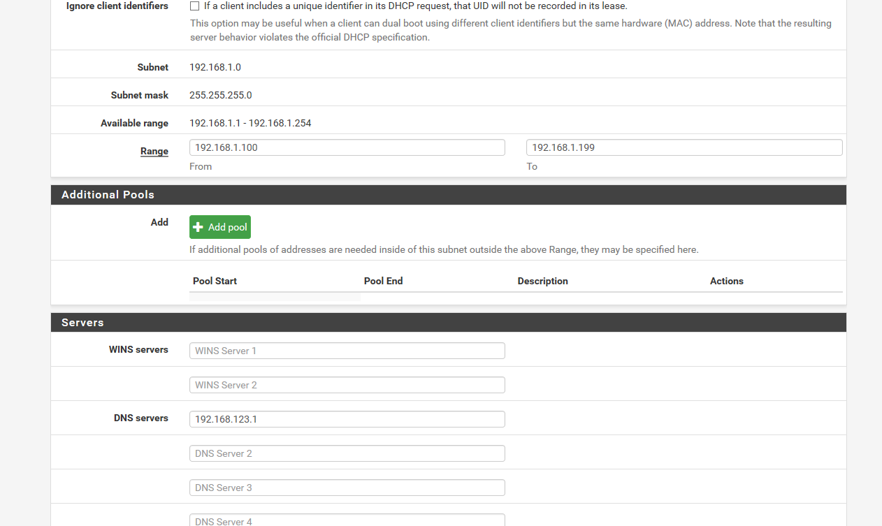

          Second, I deleted 10.4.0.1 from DHCP server and tried both leaving blank and entering the LAN IP (192.168.123.1) both didn't work. Once Pfsense rebooted each time I had no connectivity. I also disabled all my current firewall rules to remove them from the equation and no change. I can resolve websites from Pfsense but not from my LAN. I'm at a loss on what to do.
          firewall disabled
          DNS server removed (blank) and then entered LAN Gateway IP

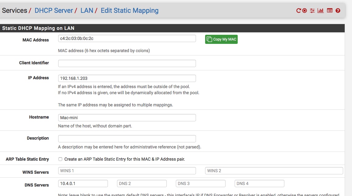

            what is your DNS resolver set too? i created static mappings for each computers for that tunnel and then plugged in the DNS server for Airvpn as shows. passes the ipleak.net tests like nothing
            0_1549327273293_airvpn.jpeg0_1549327379093_ipleak.jpeg0_1549327755437_firewall-rules-edit.jpeg
