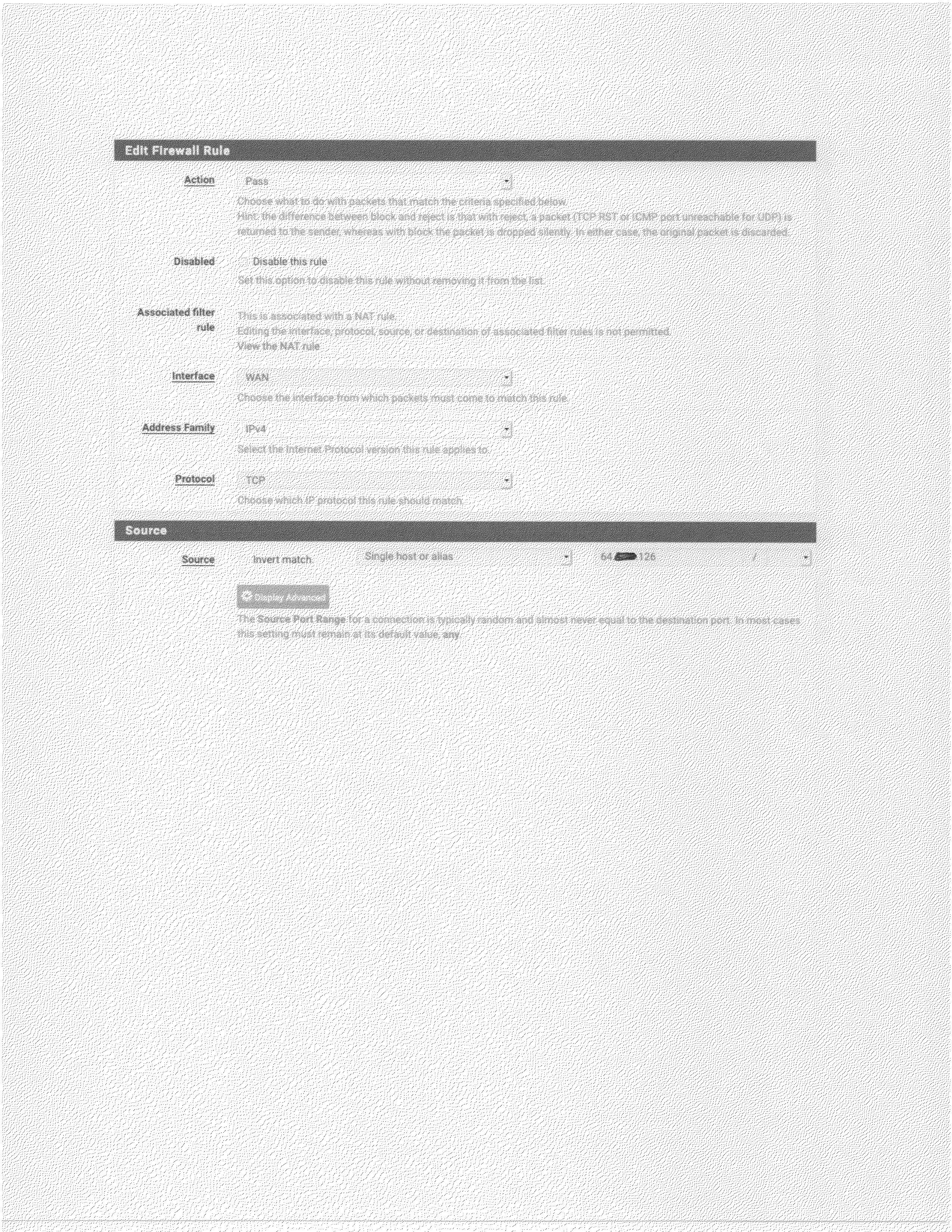

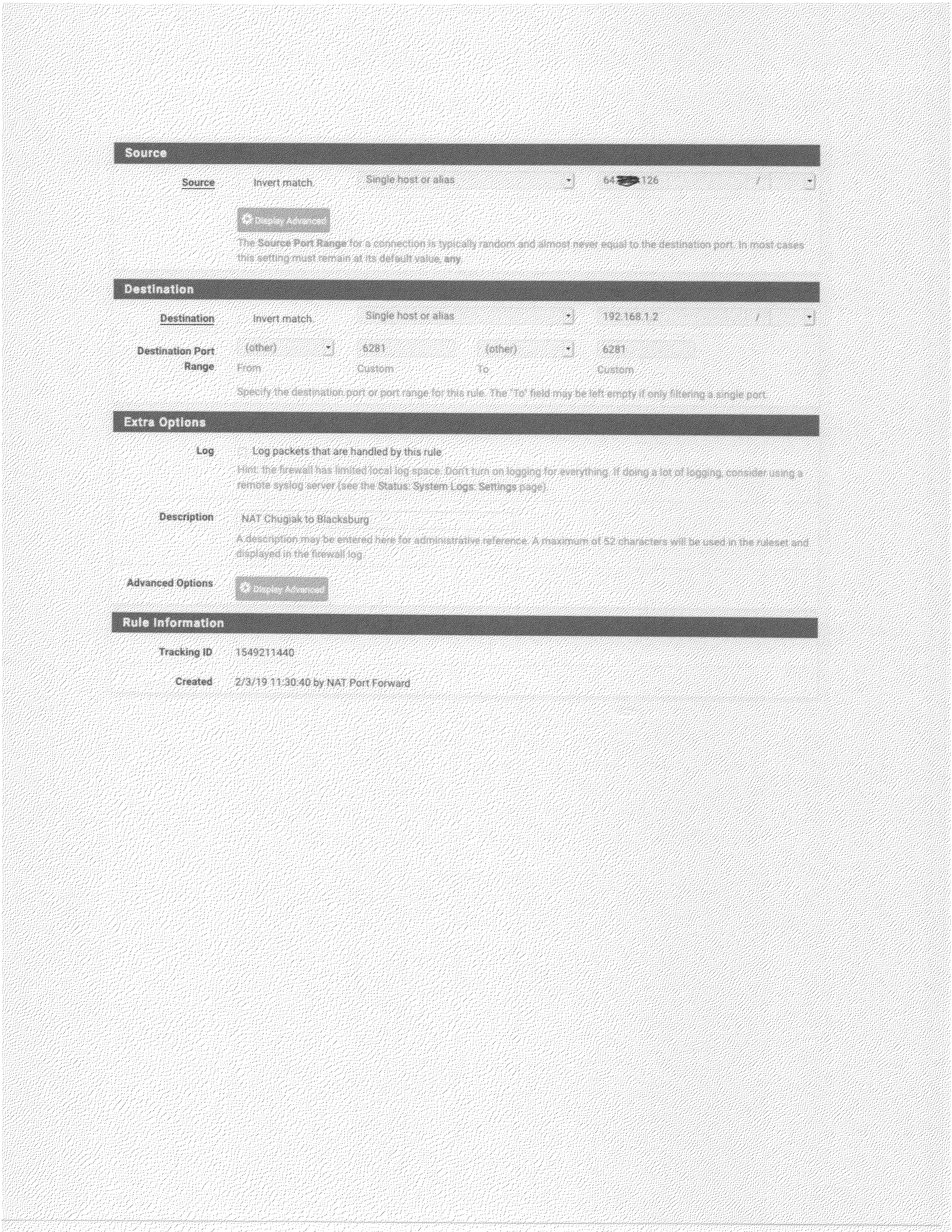

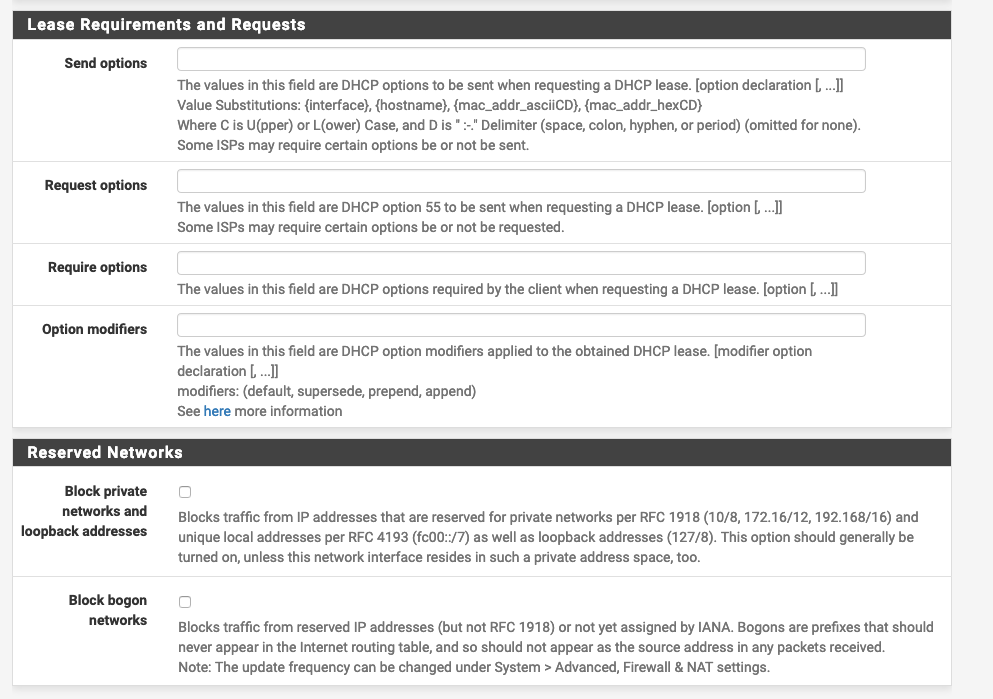

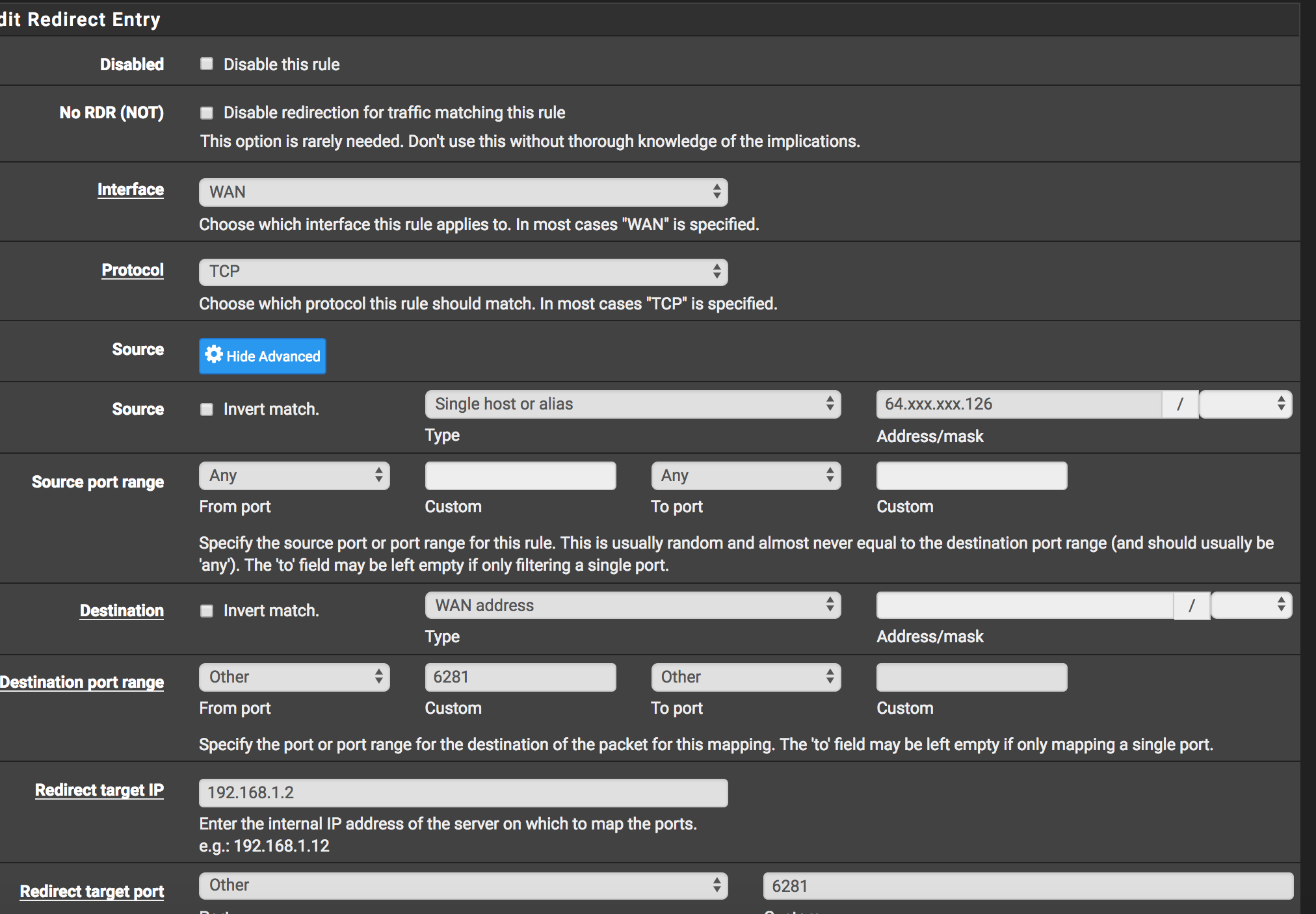

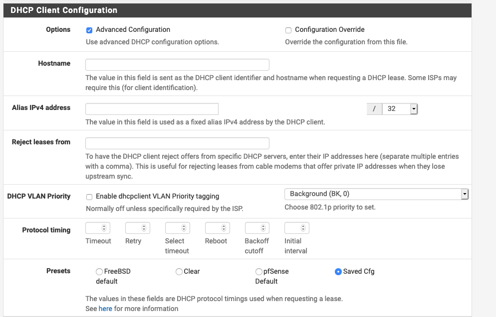

      Hello, new Netgate appliance, new to pfSense and just getting this new device configured. Fairly smooth, except for the following: I have a Synology DS in Chugiak which backs up daily to a remote Synology DS in Blacksburg. I am now placing the Netgate appliance between the cable modem and my router in Blacksburg. I must be missing something in configuring the port forwarding and firewall rule on the Netgate. I want to allow all traffic from the specific IP address hosting the Chugiak DS through the netgate to the Blacksburg DS, all ports. I have read through the pfSense documentation regarding both port forwarding and firewall rules, plus searched the forums. I have deleted and properly recreated port forwarding rules, rebooted the netgate. What am I missing? Thank you for your help!! Screenshots of my current configuration are attached: 0_1549205786283_pfSense problem_1.png 0_1549205800636_pfSense problem_2.png 0_1549205807936_pfSense problem_3.png

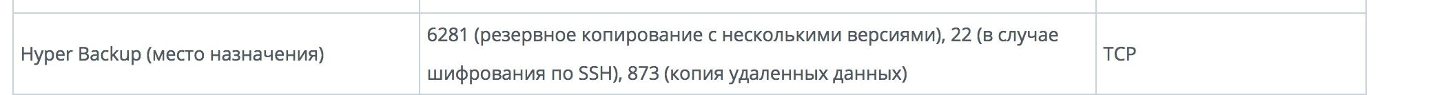

            What ports do I need to forward for Hyper Backup
            What you're doing is wrong.

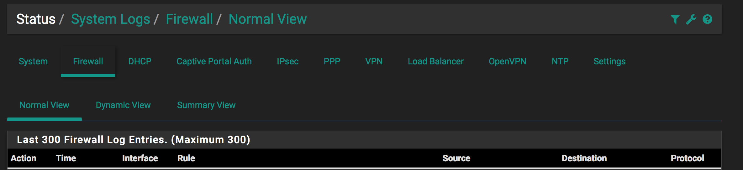

              The first picture shows that pf is blocking tcp port 6281
                AKJim @Konstanti
                @konstanti Yes, I know that. Hyperbackup is set up correctly. I just need to get the connection through the netgate to the Blacksburg DS. Without the netgate in the system everything works perfectly.

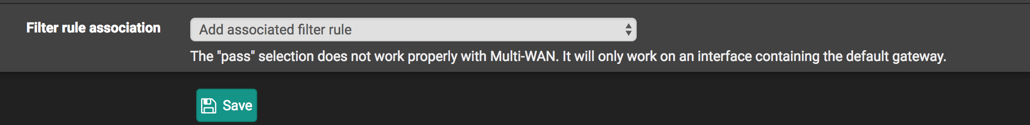

                        • K Offline
                          Konstanti @AKJim
                          @akjim
                          We have to start over
                          1. remove and disable all that in the pictures ( this is wrong)
                          2. create port forwarding for 6281 (nat / port forwarding)
                          3. check that the rule on the wan interface also appeared
                          4. try to connect
                          how is port forwarding configured on the router ?
                            AKJim @Konstanti
                            @konstanti said in Pass specific IP through to LAN, port forwarding, firewall rules:
                            @akjim
                            4. try to connect
                            1. Yes, I have removed all rules, then rebooted the device.
                            2. Yes, done
                            3. Yes: 0_1549211668263_8b4a3dc8-5d00-49f2-a971-88a7a04fc604-image.png
                            4. Still rejected by device firewall: 0_1549211712076_8168876b-5de1-4de2-9ab6-bc62b543250e-image.png
                            K A 2 Replies Last reply Reply Quote 0

                              show me the rules on the wan interface
                                AKJim @AKJim
                                @akjim Port forwarding on the router is good, this traffic is being stopped by the netgate appliance only. If I remove the netgate appliance (pfSense) then everything works correctly.
                                  AKJim @Konstanti
                                  @akjim
                                  K 2 Replies Last reply Reply Quote 0

                                      and I need a full log entry.
                                      to see what pf is blocking
                                      Status/System Logs/Firewall/Normal View
                                      where you will see :interface, source, destination, port, protocol
                                        AKJim @Konstanti
                                        @akjim
                                        this is not what we need
                                        i need
                                        /firewall/rules/wan
                                        1_1549212815787_pfSense problem 00002.png 0_1549212815787_pfSense problem 00001.png
                                        • K Offline
                                          Konstanti @AKJim
                                          @akjim
                                          here's what I need
                                          the picture with all the rules
                                          for example ,
                                            AKJim @Konstanti
                                            @konstanti There is only this one, single rule ..... !
