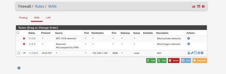

      @nogbadthebad My pfsense is only router connected. no other router in the house.

        The order of the 3rd and 4th rule needs swapping round.
        Firewall rules are read from top to bottom and why have you set a gateway

          Not really. After the port forward translates the destination address the 54-65535 rule will not match.

            @nogbadthebad Because I have a VPN on the other subnet.

              Djinn1 @Derelict
              @derelict That one is other subnet.

                              • johnpozJ Online
                                @djinn1 said in Tried everything port forwarding not working??:
                                ab.abc.6.228.56158: Flags [R.],
                                So that is where your box your sending too said F OFF!! with a RST [R].. So you need to check with the box your forwarding 8080 to why its not allowing the 8080 connection.
                                Has nothing to do with pfsense.
                                  Djinn1 @johnpoz
                                  @johnpoz
                                  So you mean something blocking in my PC?
                                  • DerelictD Offline
                                    Derelict LAYER 8 Netgate
                                    192.168.1.100 is REJECTING the connection attempts. You will need to look there.
                                    Chattanooga, Tennessee, USA
                                    • johnpozJ Online
                                      Yes pfsense did exactly what it was told to do it forwarded the traffic to your box behind pfsense.. That device basically told the connection to F OFF!!
                                      This is the SYN [S]
                                      ab.abc.6.228.56182 > 192.168.1.100.8080: Flags [S]
                                      This is start of a tcp connection.. Answer back should of been SA, ie SYN ACK - say sure lets talk.. vs the RST that basically saying GO AWAY I don't want to talk on this port..
                                        Djinn1 @johnpoz
                                        @johnpoz said in Tried everything port forwarding not working??:
                                        But i have disable antivirus and windows firewall how can the PC be blocking?
                                        • johnpozJ Online
                                          Doesn't have to be blocking - dpending on the OS if the port is not being listen for then it would send back a RST..
                                          Check on the .100 machine that its actually listening on 8080, simple netstat command will show you what ports are being listened on.
                                          D 2 Replies Last reply Reply Quote 0
                                            Djinn1 @johnpoz
                                            @johnpoz I am using windows 10 can you tell me how?
