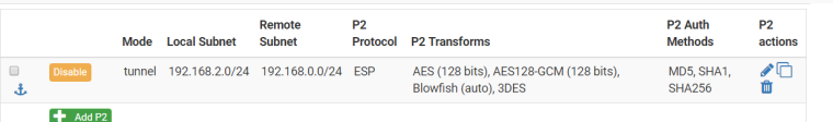

the phase2 configuration (side pfsense) in attach.

the problem was solved by modifying, in phase 2, the protocol and Auth Methods as the one configured on pfsense were not compatible with those used on the fortigate.
