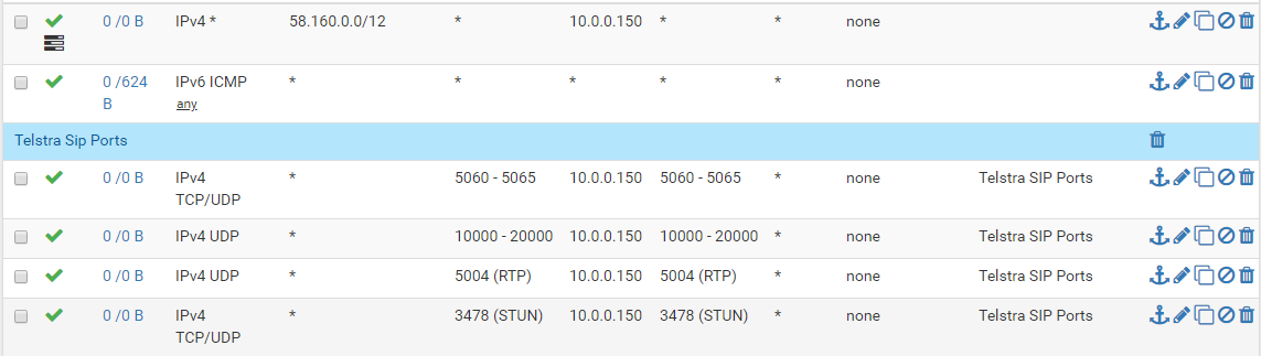

            What's with the top rule ?
            You are passing everything from Telstra to 10.0.0.150

                  Hmm, yeah if you just have a phone I would not normally expect anything to be required. Some providers might require static outbound NAT.
                  I assume you have port forwards in place for all those ports? Those doen't look to have been added automatically by the port forwards though.
                  What happens if you have none of those rules enabled? Does the phone register?

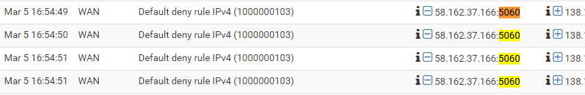

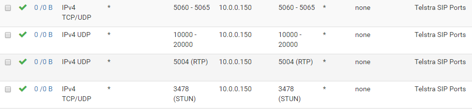

                                      so for an incoming call
                                      if i turn off all the rules i get this:
                                      if i open just all the ports in my rules i get:
                                      with
                                      capturing a sip packet i get... a ringing phone? WTF?!?!?!
                                      seems its a 1 off though as it didn't ring the next 3 attempts

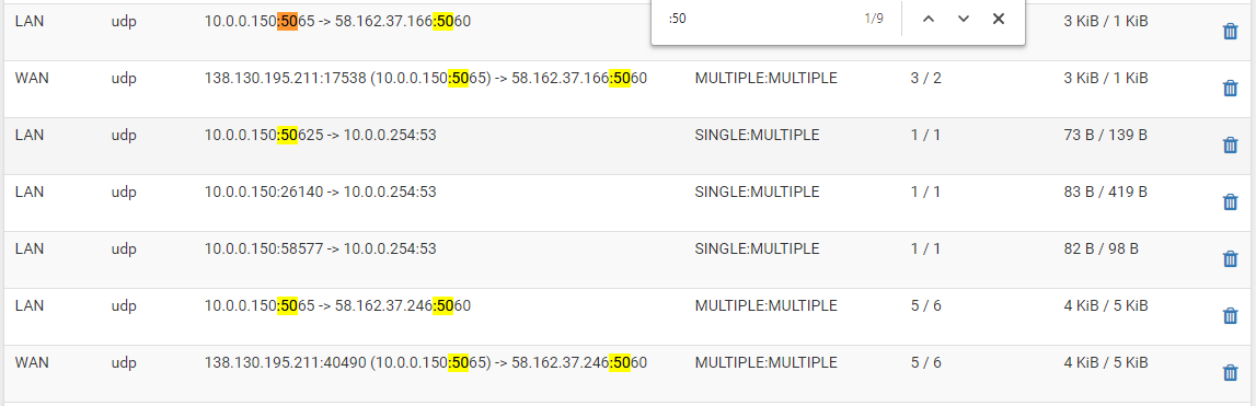

                                        What I expect to happen here is the phone connects out to the SIP server at port 5060. If you don't have static outbound NAT set for the phone IP the source port as that leaves the WAN will be randomised. The phone holds that state open with keepalive packets so that when the provider sends traffic to it for an inbound call it still passes through the firewall.
                                        Since you are seeing it blocked that state is either not being held open or the provider is replying to the wrong port.
                                        Check your state table for the phones IP. See what source port it is using, is it port 5060?
                                        Is it holding open a SIP state at all?
                                        It could be you need a static outbound NAT rule.
