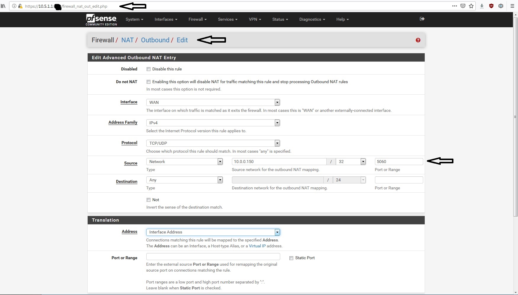

                                  But- If you have SIProxd in place and the system is still trying to connect to a port other than the 5060 to 5080 range as in your picture above then the box is not connecting to the proxy. I would take it that you do not have anything showing up in "registered devices". You might leave it off the air overnight and then try again in the morning. Your SIP server and device are probably holding on to an earlier registration.
                                  You can set up a static port in the router at Firewall/Nat Outbound NAT tab. Make the whole LAN address of the device "static" and see what that does for you. If this box connects correctly your firwall will show connections to your LAN device and never your WAN address. That is why I think they are doing something hinky.

                                    Redirect Target Port is a numerical input and not what you have typed. If you want a 1:1 then do a 1:1. Otherwise do a port forward for each port or range of ports.

                                          The states from that box
                                          • chpalmerC Offline
                                            chpalmer
                                            Have you tried a Static port?
