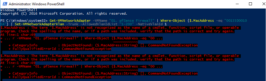

                • HermanH Offline
                  Herman @Herman
                  Hi Folks,
                  I tried the following command. Somehow something went wrong.
                  This is the solution @bobtheninja provides. Any ideas?
                  Regards Herman
                  Limburg | The Netherlands.
                  It is nice to be important. But it is more important to be nice! | Failure, the best teacher it is!
