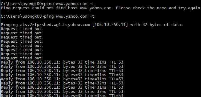

I thought this was isolated to one of my Windows 10 machines so I posted in the tenforums website. But it looks like it's happening to two Win10 machines that I tested now. It's not always happening but it does frequently, mostly after restarts. Here are some tests I've done with both my machines and they have the same exact results:
One machine was after a restart and the other is after resuming from sleep.
In example 1, I've ping'ed google and it already had a resolved IP (probably because of the machine's cache) but did not respond properly. In example 2, I wasn't able to resolve yahoo during the first ping but it did during the second ping, although it wasn't also responding. Both servers started to respond properly at the same time.
Any ideas here? I could only think of pfsense causing this because it is experienced by more than one machine.
@kevindd992002 said in DNS Resolve Domain Overrides do not work after pfsense restart:
Looks more like just connectivity issue then dns related problem.
In your first you have an ip but it just not get a response.. So where was the communication breakdown, did you ping even make it to pfsense, and that is where the ball got dropped, or did not even make it to pfsense..
The 2nd one is odder since looks like you could not resolve, but then you did - so would seem to say you could talk to pfsense and get an answer to your dns query.. But then your pings take a while to get answered?
Windows has always been know to have issues with coming out of standby and network connectivity, or even taking a while for the network stack to fully start.
I should've done a tracert to make sure. Well, before these two tests I did an nslookup which points to pfsense by default. And it also fails there, which made me think it's a DNS issue in the first place. But then the first test in the screenshot above doesn't really point to a DNS issue because if it was then I would get responses right away.
But where did you get the IP from in your ping if after a "restart" there would be no cache at all.
Are these clients wireless?
