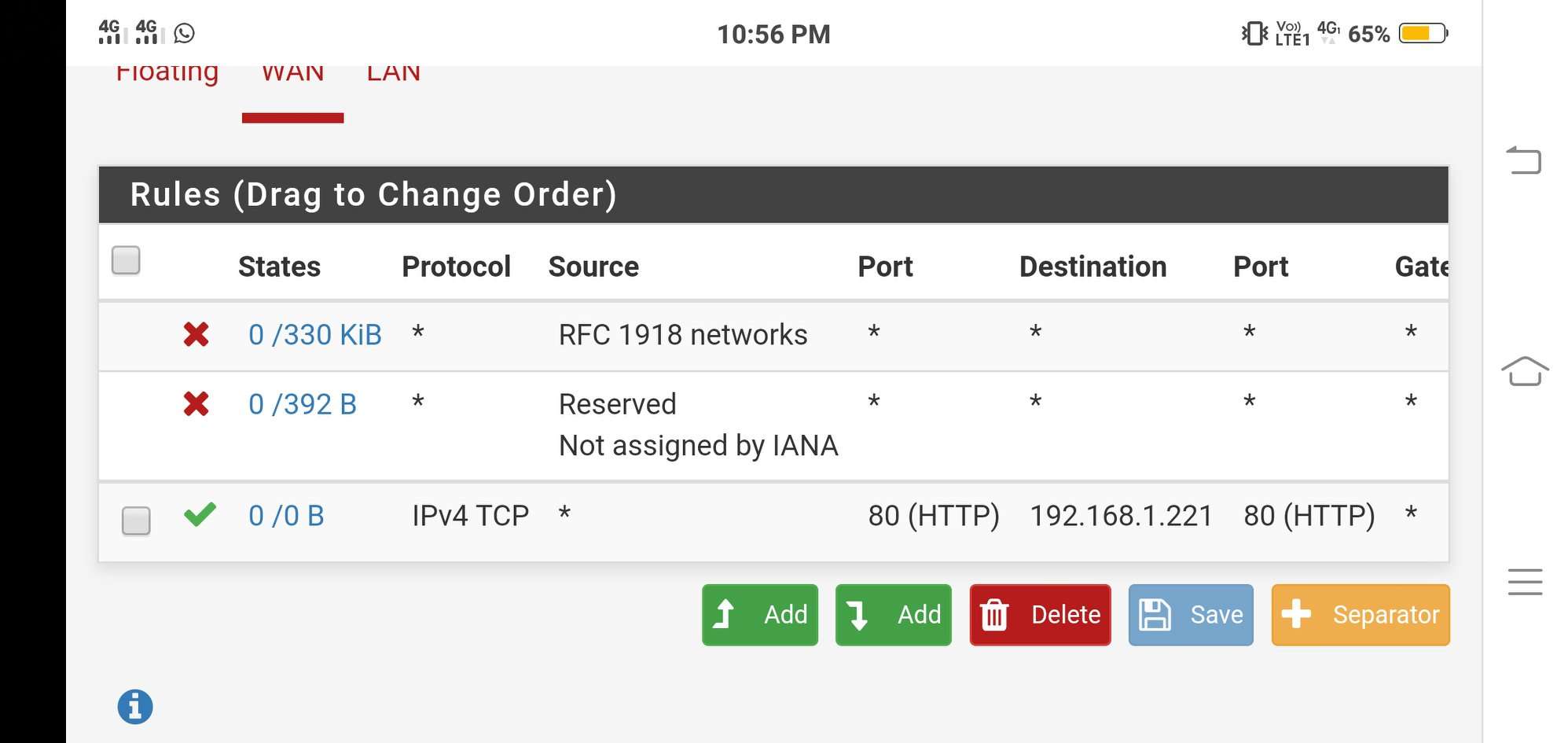

                  • P Offline
                    patelsaheb @stephenw10
                    please check snaps
                    thank you

                    • DerelictD Offline
                      Derelict LAYER 8 Netgate @patelsaheb
                      @patelsaheb Don't set a source port.
                      You don't need floating rules. delete them.

                              @Derelict
                              can you check snap is it correct or not?Screenshot from 2019-05-30 10-19-20.png
