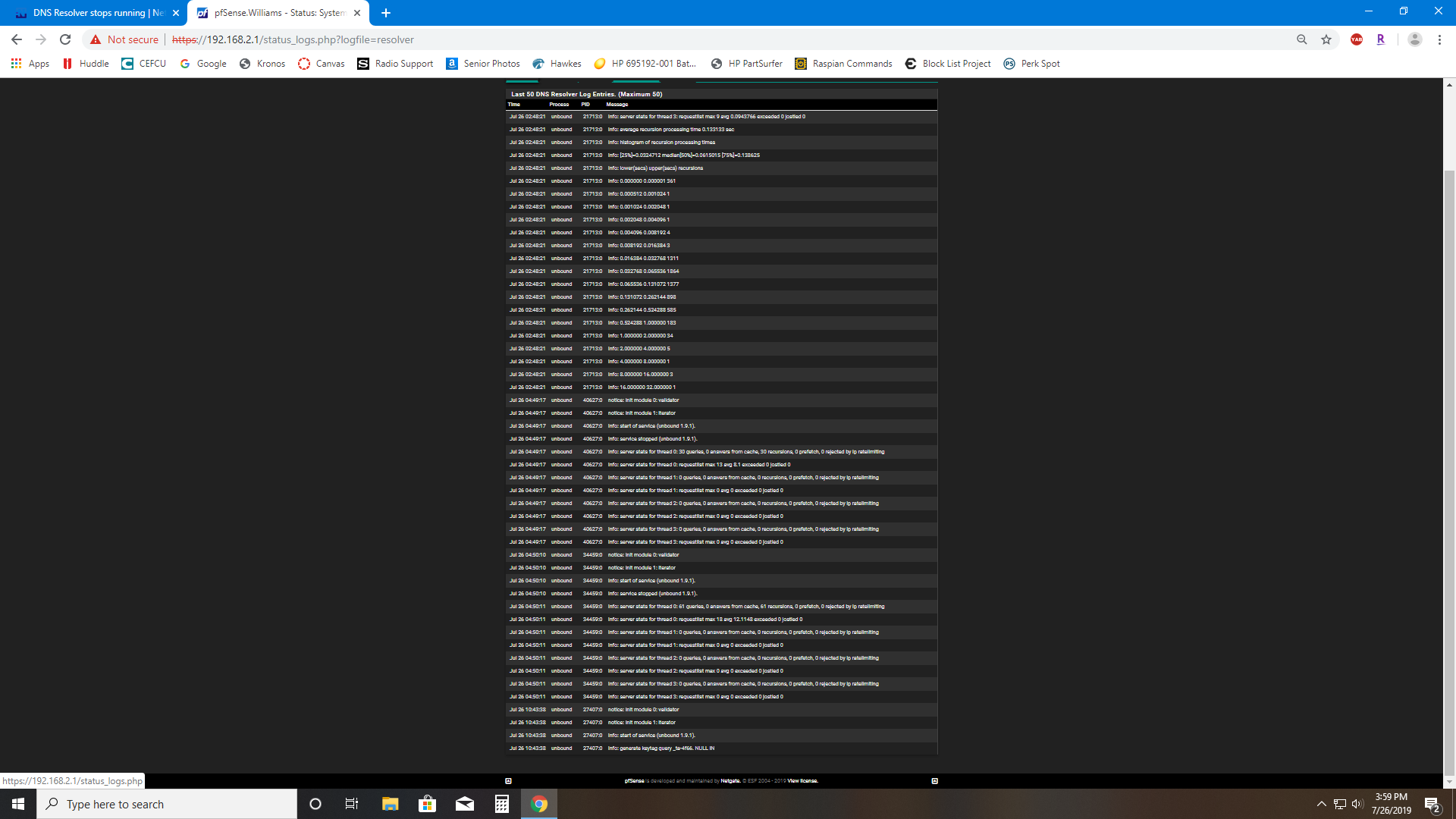

            cpugeek1999 @KOM
            This what I have
            • KOMK Offline
              KOM
              That's only a 4-hour span from today. If it didn't crash in that time then there is nothing there in the WebGUI view.
              Shell in and check /var/log/resolver.log. It should have more history, and look specifically around the time that it crashed.
