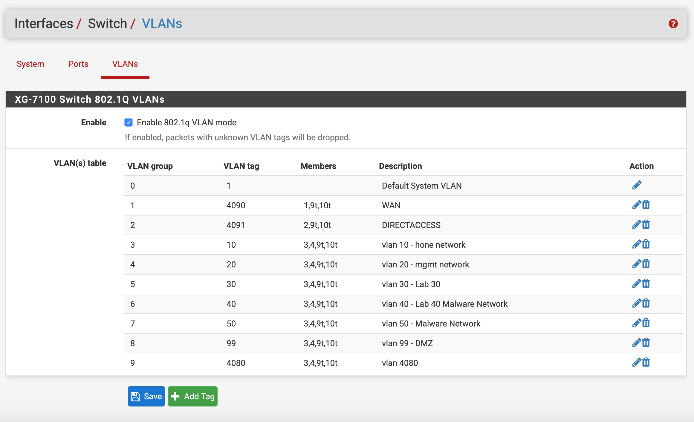

      I started by creating the switch vlans
      I have tried this configuration without switch VLAN 4080, but just recently added that on my last try.

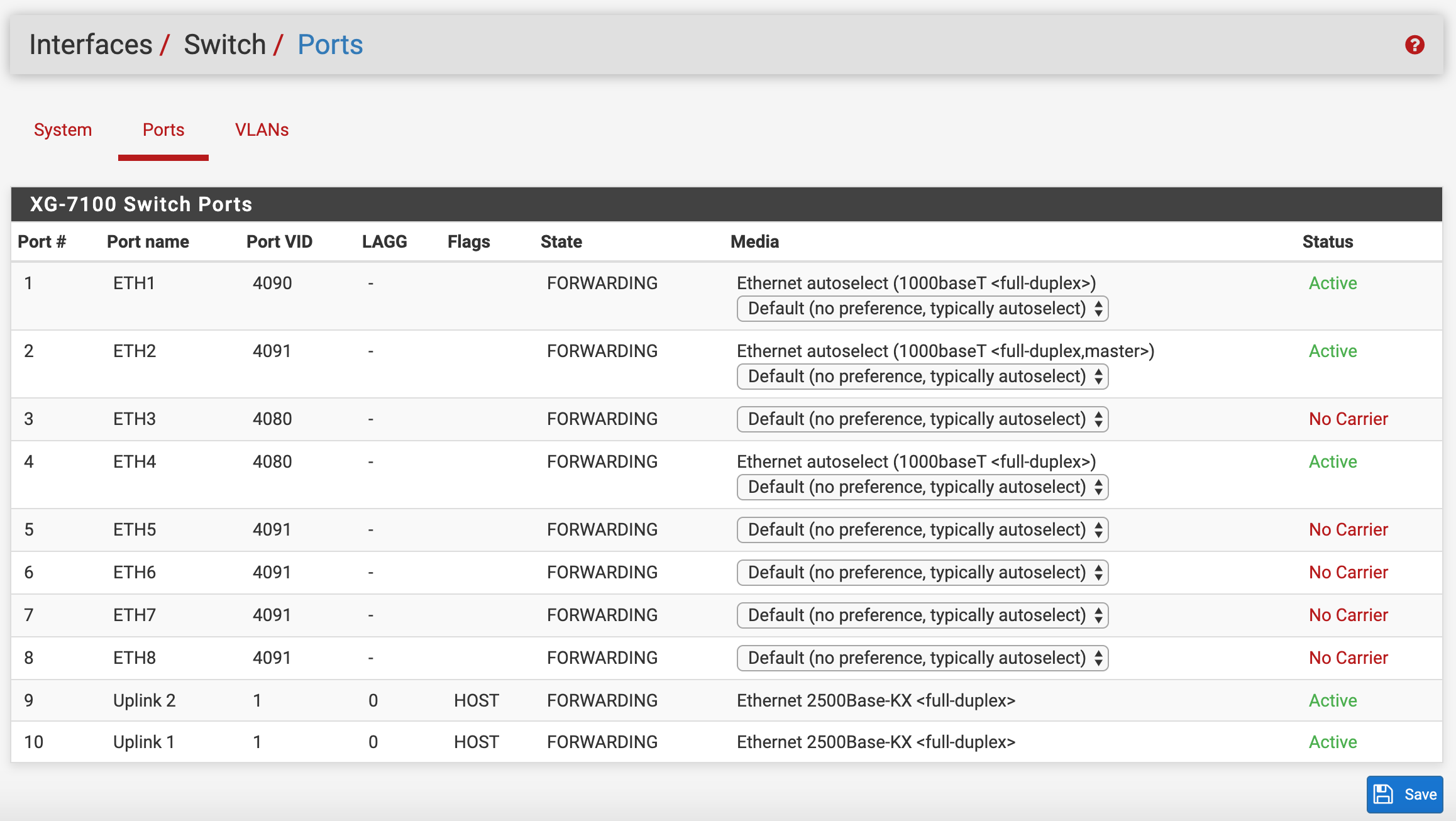

      I made the PVID 4080 on switchport 3 and 4, but my last attempt was with only 1 trunk and no port-channel (on the 3560). I also tried it with LAGG 1 on both switchports 3 and 4.
      Attempted with a single trunk on G0/15 as well as a port-channel with G0/15-16 in it.

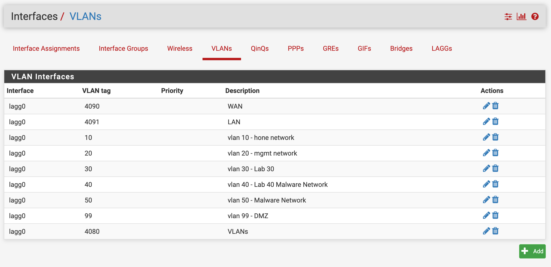

      Then I assigned the interfaces
      Any input as to what I am missing is appreciated. Do I need to enforce tagging on switch VLANs 10,20,30,40,50,99 (ie 3t,4t,9t,10t)? Do I need to assign and enable an interface for the 4080 VLAN or the lagg0(uplink)?

        Solved it. When adding the switch VLANs, making members 3, 4 tagged enabled the hosts to communicate. See below for screenshots of working trunks.

          Yes, you can assign only one not-tagged vlan on switch port. I suggest you need one non-tagged - default vlan, and all other vlans can be only tagged on same interface.
