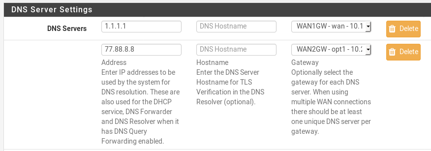

    You can set gateway for each DNS server under System / General Setup
    For example:
  • @viktor_g i have my dns servers configured like that, but seems DNS Forwarder only used the default gateway. I guess the WAN could be specified by the dnsmasq custom options fields, but not sure if it would accept alias.
