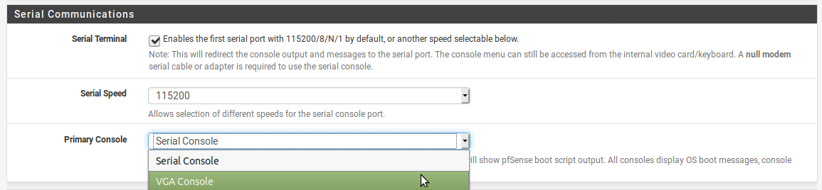

                  @stephenw10 thanks, it's exactly problem you told , I tired and it worked but how do I make it permanent.

                    You can set the primary console in Sys > Adv > Admin Access once it's booted.

                      Thanks, all up and running now.
