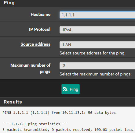

        do nothing to resolve it. I can also confirm that if I try to perform a ping from the WAN interface to the outside from the web-configurator, it will succeed. If I try the same from the LAN, it fails. So it seems like the WAN gets its network setup, but doesn't pass it through to the LAN appropriately.

            Unfortunately that isn't the issue (with mine at least), but I tried it anyway. I set the timeout to 900 seconds, but the same issue remained. pfSense gets its IP right away and is able to ping the outside world immediately from the WAN connection, however the LAN doesn't connect.
            However, as soon as I hit "Save" on the WAN interface without changing anything, everything connects:
              So not the same issue then.
              Sounds like you have no default route. Check in Diag > Routes when it fails.
              If so go to System > Routing > Gateways and set the WAN dhcp gateway as IPv4 default rather than 'automatic' which it probably is right now.
