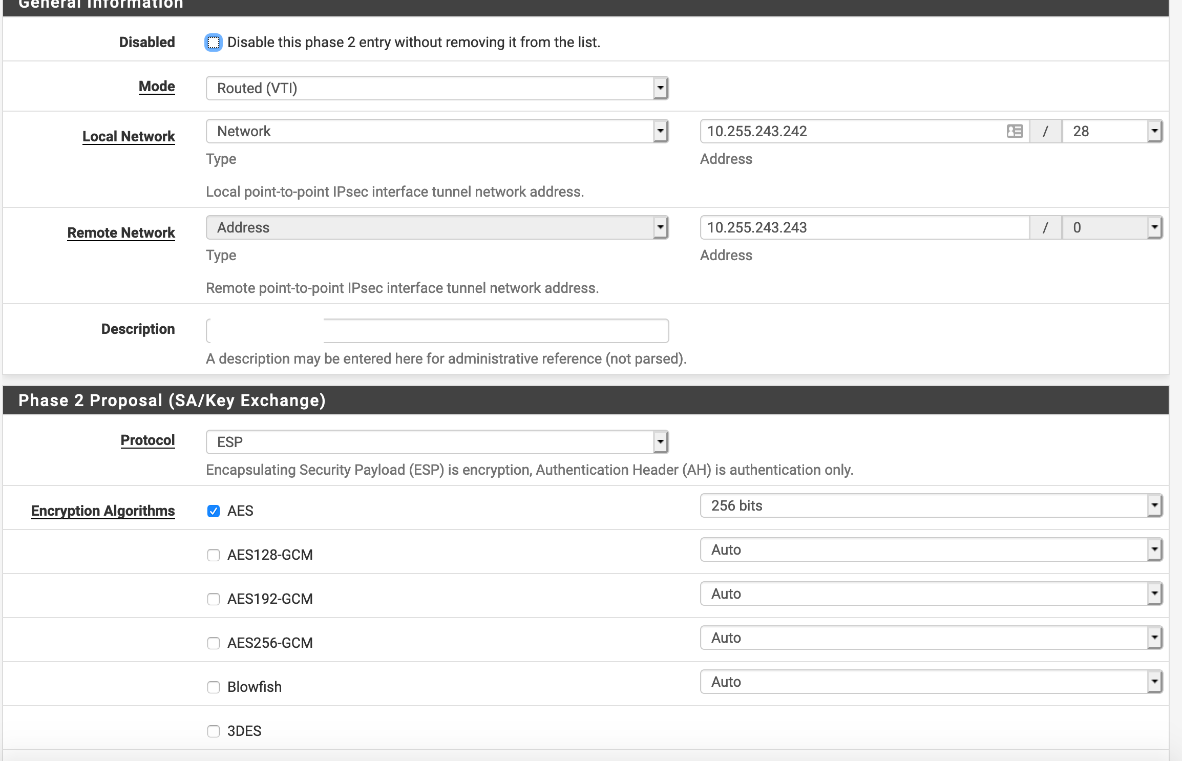

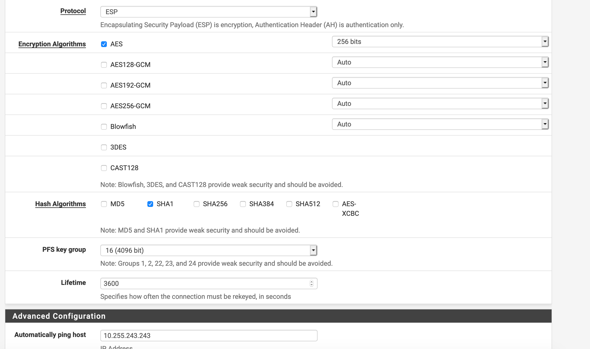

      pfSense IPsec setup:

        Has anyone an Idea how to fix this Issue, that the pfSense receives the traffic at the correct interface and we can send traffic to the other site without receiving the "Network is down" error.

            ipsec1000: flags=8051<UP,POINTOPOINT,RUNNING,MULTICAST> metric 0 mtu 1500
                    tunnel inet XXX.XXX.XXX.114 --> XXX.XXX.XXX.253
                    inet6 fe80::10d4:df6d:5e75:438d%ipsec1000 prefixlen 64 scopeid 0xc
                    inet 10.252.243.242 --> 10.252.243.243 netmask 0xfffffff0
                    reqid: 1000
                    groups: ipsec
            Very strange the tunnel is now up and it seems to be working.
            Niw the problem is, that if we ping the other site no response from the host is coming. But on a tcpdum we see, that the ICMP reuqest was received and the echo is send.
