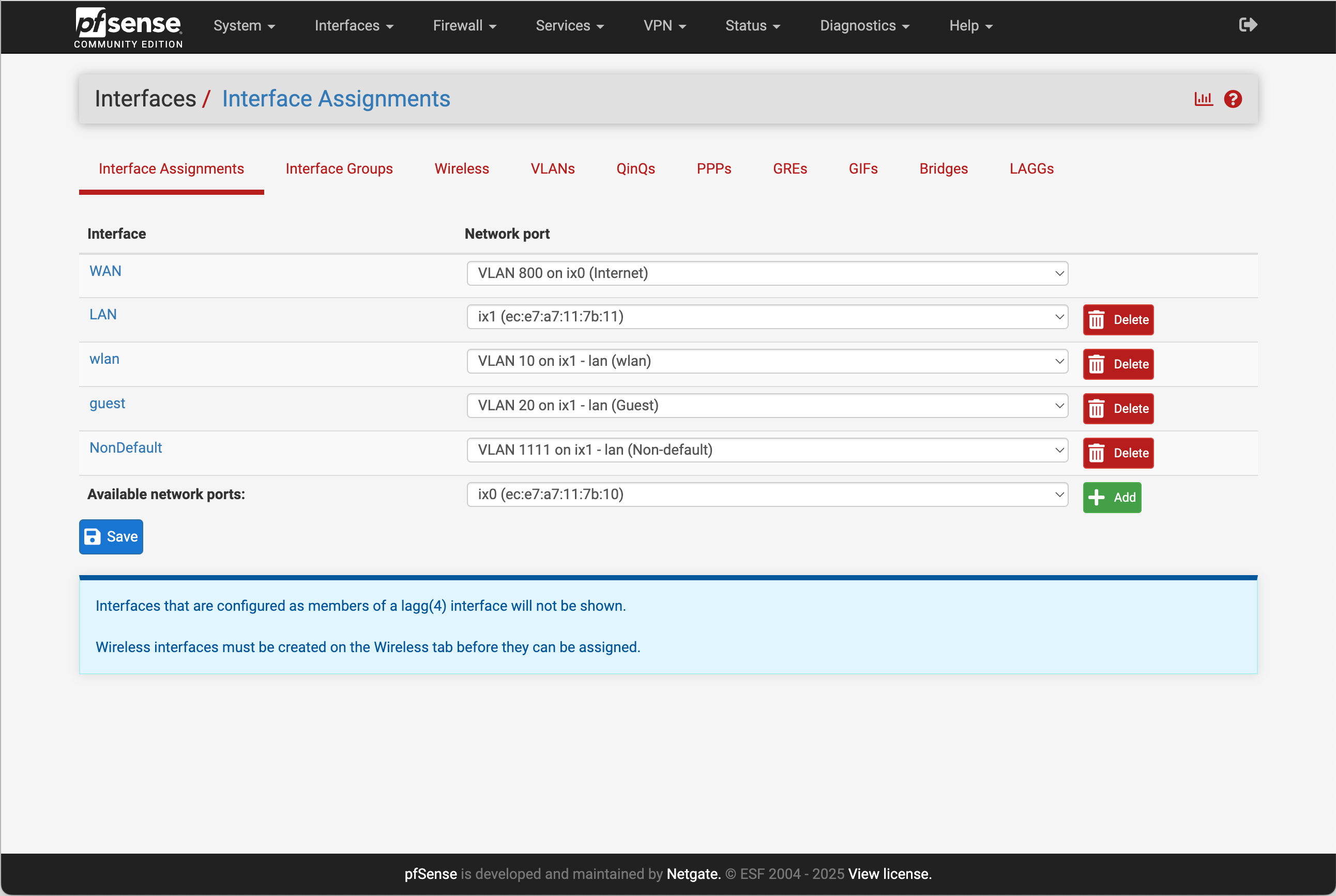

    @Gblenn I would have followed up earlier but have been busy with both the network and other stuff. I still appreciate your advice. And I have been reading more about the concept of VLANs. The old D-Link is still in the rack and I use it for a "backup" so I can go back to this if the Unifi switch does not work. Theres is another problem that I haven't been able to solve. The Unifi controller holds all the configured wired and wireless networks even if I use hardware reset on the switch. But no matter what I do, the switch appears to be offline after a few moments. And even if it still handles the traffic according to the configuration, it is offline in the sense that I can't ping it or log in with ssh. When I use the old switch and just connect the new one through a single cable, the switch can be adopted and configured. I have read a lot of post about similar issues at the Ubiquiti Forum. Some suggests to manually change the inform host like this set-inform http://ip-of-controller:8080/inform. This seems not to change anything. Other suggestions are to add an 43 option to the DHCP server (pfSense) or make a host override at the same place. Do you have any suggestions?
