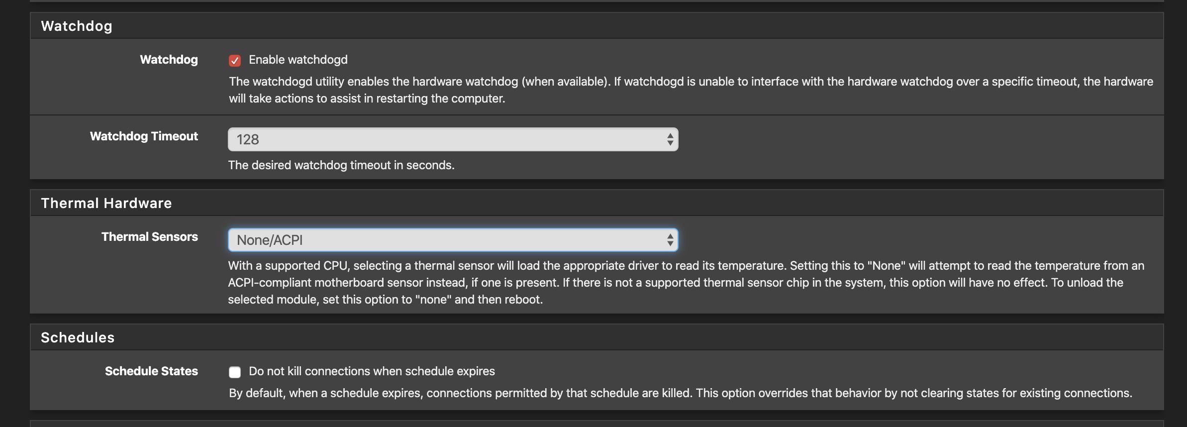

I have a SG-3100 and I've just noticed that this parameter has disappeared after my upgrade from 2.4.4-P2 to 2.4.5. Before, it was Cryptographic & Thermal Hardware and not only Thermal Hardware

Second, that option was removed for SG-3100 because the cryptographic devices are buit into the kernel and cannot be disabled. The option did not affect anything on that hardware model, so it was removed.
