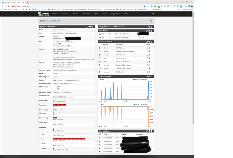

          Thank you for responding. There are no errors on the interfaces page but Here are some screenshots of the drop outs that I see on the dashboard. Where you see the dip is where everything slows down to a crawl. There are 4 images to show this at different times. This happens 5 or 6 times every hour and I just cant figure this out. I have changed the ethernet cables as well.
          And no errors shown here

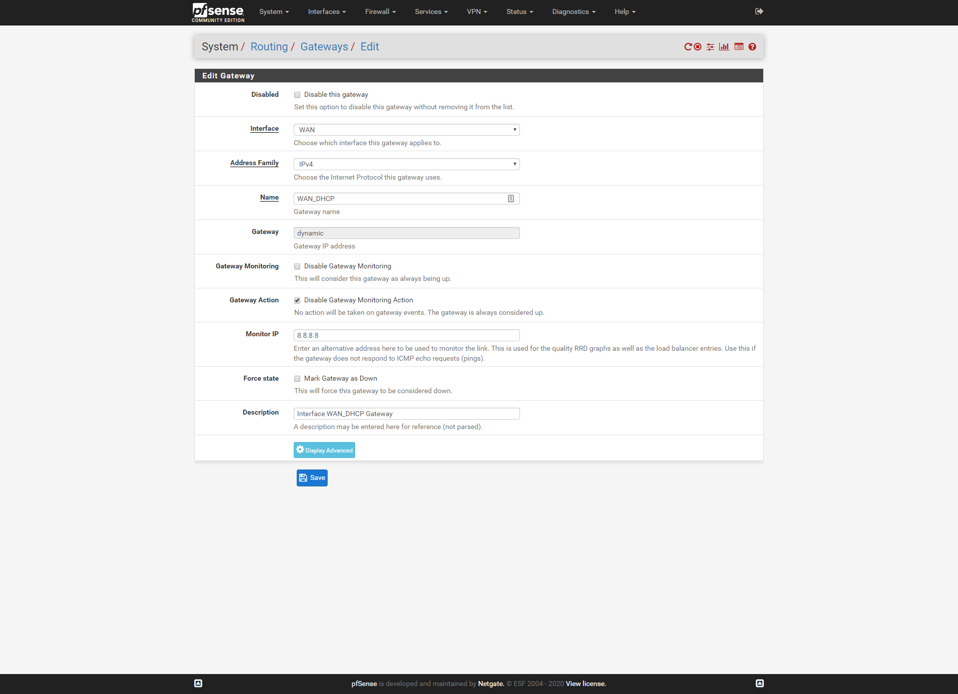

                      Well it's showing some very bad gateway latency and/or packet loss that is reloading stuff.
                      That could be the gatewau itself or you could be hitting this: https://redmine.pfsense.org/issues/10414
                      Check the System Activity output when you are seeing this issue if you can.
                      If you are confident the gateway is not actually having issues you could set the monitoring IP to something else like 8.8.8.8.
                      You can also disable the monitoring action do it does not reload the firewall rules even if if it sees high pings.
                      https://docs.netgate.com/pfsense/en/latest/routing/gateway-settings.html

                        alitech
                        Thank you Steve.
                        I have done what you have recommendedscreencapture-192-168-1-1-system-gateways-edit-php-2020-04-25-14_05_22.png .
                        I will provide logs if anything shows up in the system logs.
                        Thanks a bunch

                              Steve, it seems that the monitoring was causing the issue. I have set it up so it always assumes that the connection is live. Also nothing is reloaded as a consequence. So far the system is behaving, however I have experienced a slight lag in the connection for a couple of times 1 or 2 mins each time.
                              I am still monitoring the situation. Hopefully it behaves. I will of course report any abnormalities.
                              @Cool_Corona I have removed the block on bogon networks as well on the WAN.
