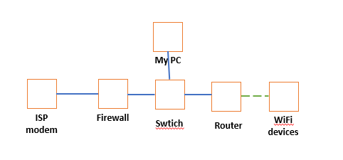

      First, basic information about my home environment:
      • Firewall: pfSense running under a Protectli Vault 4 Port, Firewall Micro Appliance/Mini PC - Intel Quad Core, AES-NI, 4GB RAM, 32GB mSATA SSD
      • Switch: NETGEAR 8-Port Gigabit Ethernet Smart Managed Plus Switch (GS108Ev3)
      • Router: Linksys EA3500 - Dual-Band N750 Router with Gigabit and USB
      • ISP router: Sagecom
      Everything is connected to the switch. I have a port mirror in the switch to all ports so I can sniff everything with my desktop to send it to a NSM solution. (Network Security Monitor)
      I have VLANs tagged in the switch and my router is in bridge mode.
      What is connected in the router:
      -Couple sonos
      -3x smartphones
      -TV
      -Laptops
      -Kindle
      -Few other devices
      I am finding a lot of issues with my WiFi and I can't find why. With a Wireshark traffic capture in my WiFi network I have seen a lot of retransmissions. When I reboot my router things get's better but with time packets starts to get stuck. I am inclined to say that it is my router, but I can't confirm.
      I was wondering, based on the usage and purpose (home network / lab)...
      1. Do you guys think it is really the router? Or it might be something else?
      2. What alternative routers would you guys recommend with both 2.4 and 5ghz? I am from Brazil, so a cheap option is required (e.g., an Ubiquiti UAP-AC-PRO-US that cost U$ 130, here in Brazil is around U$ 280).
      Any thoughts?
      • johnpozJ Online
        So your using your EA3500 as actual router doing nat, or your using it as a AP?
        If your having issues with "wifi" then get better wifi - as to cost.. Yeah good stuff isn't cheap..
        The 3500 isn't even AC... its quite OLD.. and Slow!!!
          andrecvnt @johnpoz
          @johnpoz said in Home setup issues with WiFi (advice):
          EA3500
          I am using as a AP. My pfSense is also my DHCP, there is no NAT between my EA3500 and PfSense.
          Yes, it is indeed old! I am willing to spend some money but I just want to make sure I won't but something that is still not good enough.
          Which APs you think it is worth buying? Or which characteristics you think a I should look before buying?
          I live in a small apartment (like 70m²) so a big range isn't it that important.
          Thanks for replying!
