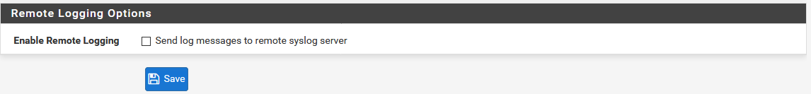

        • hawkbhH Offline
          hawkbh @ptt
          Hi @ptt. Thank you for watching. Screenshot below:
          • pttP Offline
            ptt Rebel Alliance
            I'm using this settings, since long time, without any trouble.....
