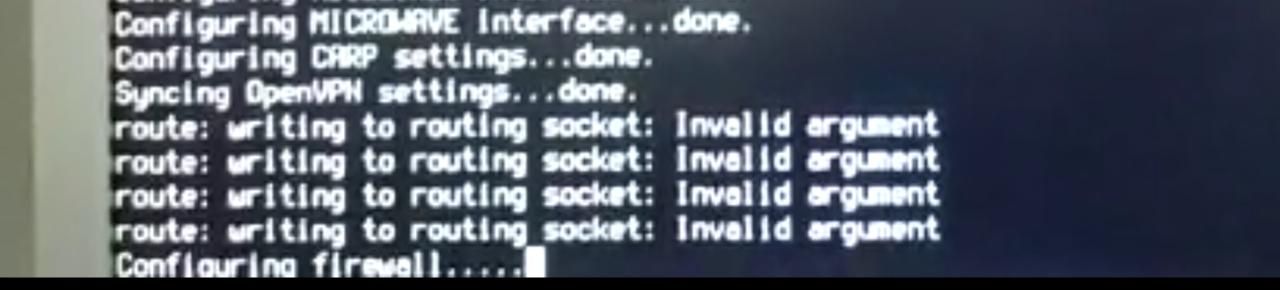

      I noticed also an error during bootup that i will also attach
      what can be the cause of this issue? from where shall i start troubleshooting ?

        about the console messages:
        https://forum.netgate.com/topic/117476/route-writing-to-routing-socket-invalid-argument

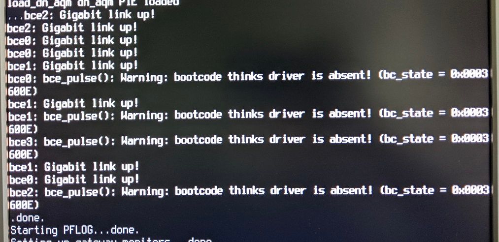

          also can the error in the attached image below be the cause of the issue, i noticed it during reboot

                  reverting back to previous version of pfsense 2.4.4-p3 , everything is working fine and the bce_pulse error don't show anymore
                  i think that is the main issue but i can't figure out how to solve it
                  something between the freebsd 11.3 and the bce cards needs to be checked
