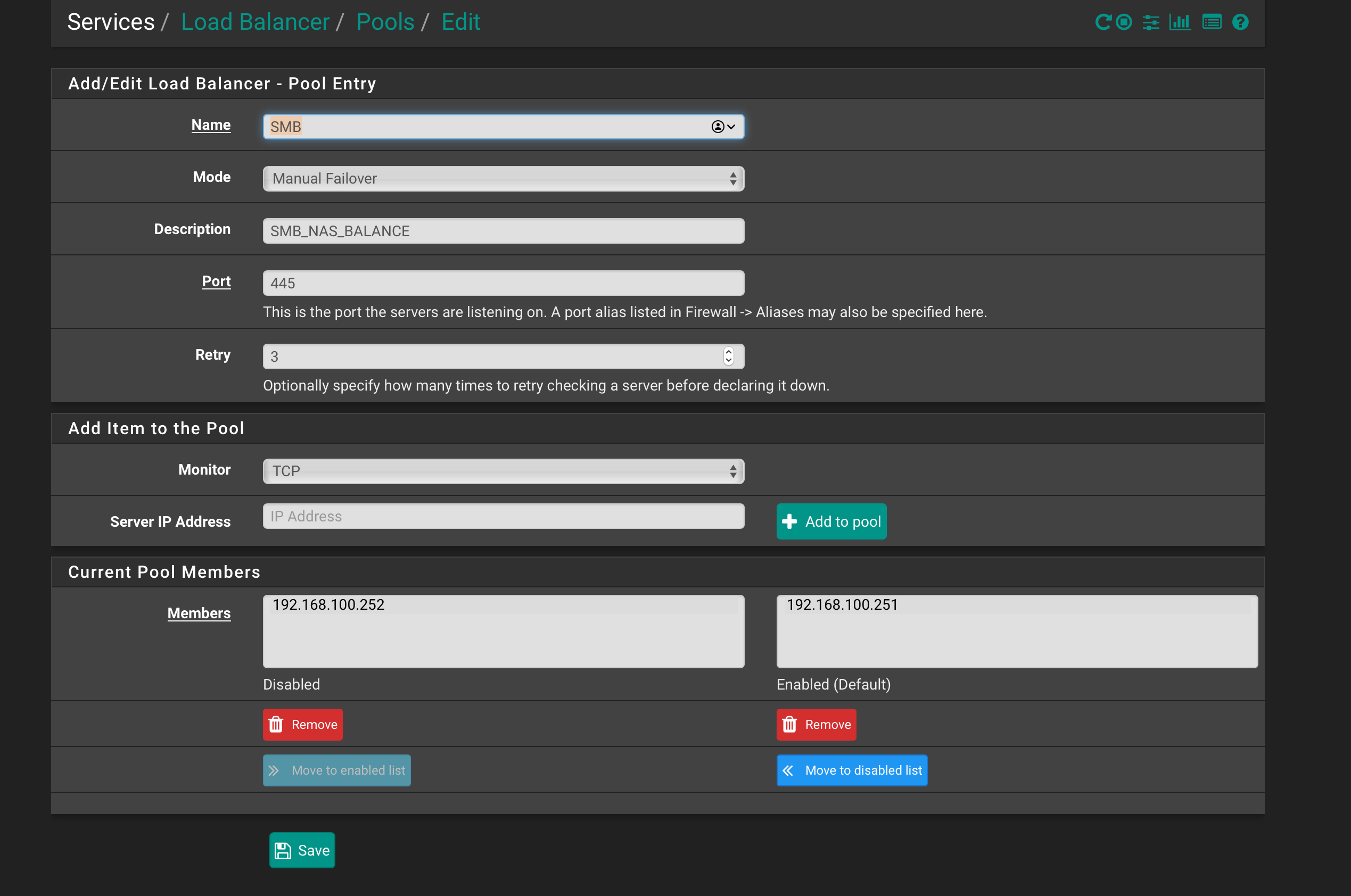

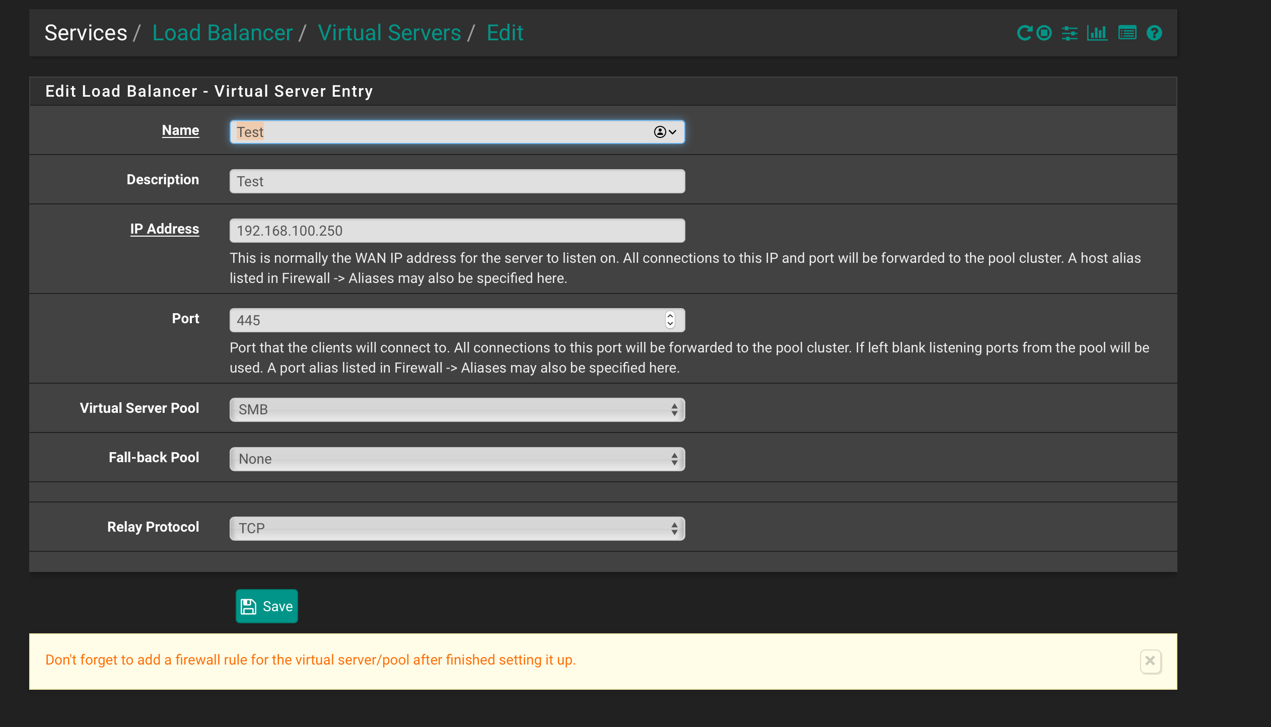

      I configured a Virtual server (192.168.100.250) on port 445 for two NAS shares replicating each other that are 192.168.100.251 and .252.
      I can see it from IPSec and mount it, but not from LAN.
      A machine (192.168.100.2) into the same LAN is returning no route to host. This is strange as it should be direct access to 192.168.100.250.

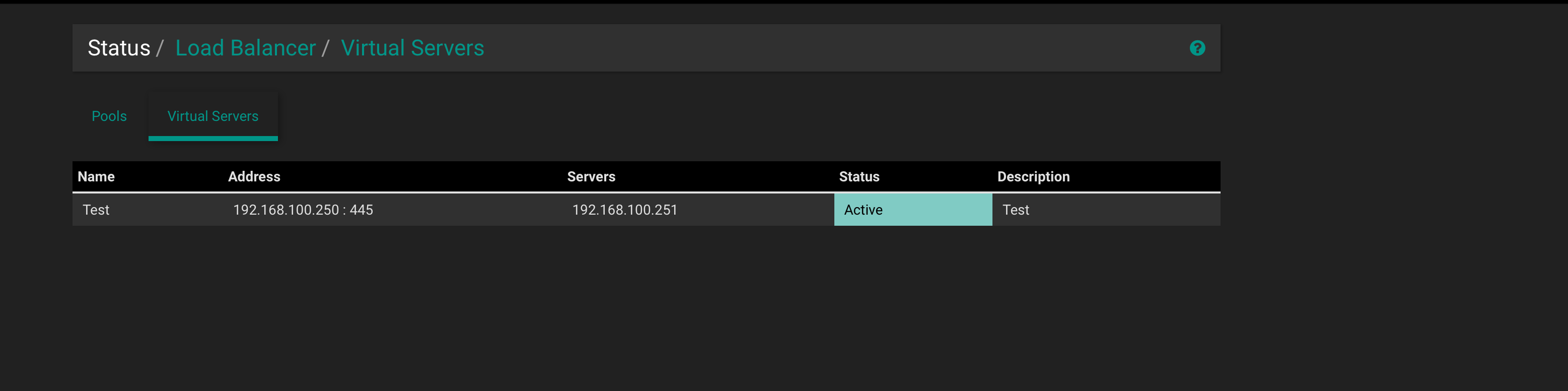

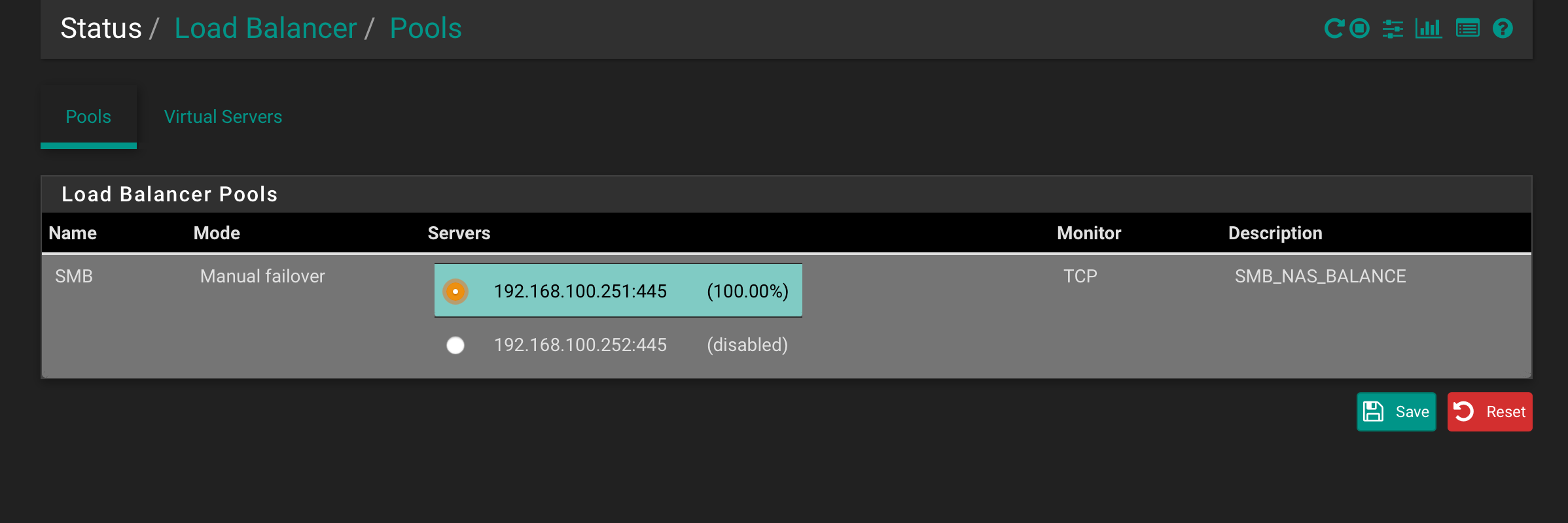

      Here screenshots of the config.
      Schermata 2020-06-18 alle 02.19.57.png Schermata 2020-06-18 alle 02.19.53.png Schermata 2020-06-18 alle 02.18.58.png Schermata 2020-06-18 alle 02.18.50.png
