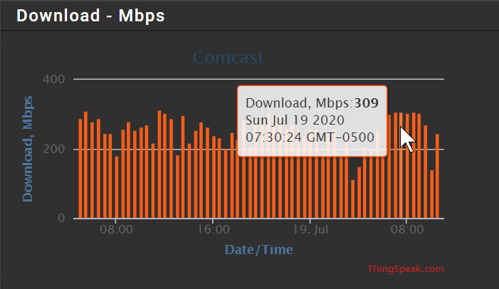

      I see for years users have asked how to do speed tests with pfSense. From the GUI there should be a widget that we can put the ISP's ookla speedtest server in and have it run against it on demand as well as scheduled. The results need to be presented in a bar chart to see what days or hours in a day are slow.
      It has been asked for many years ago. I know this seems petty but there are ISP's that over commit and if our users know that they can ask for non-shared service to the home or switch from provider X to provider Y.

        This was recently done
        give me a sec to find it. brb
        here
        https://github.com/aln-1/pfsense-speedtest-widget
        Here is the thread about it
        https://forum.netgate.com/post/913011

          Thanks, I installed it but I really think the guys at Netgate need to add this to pfSense, so it will work when you do upgrades and you can decide how frequent to run, to log and to chart.
