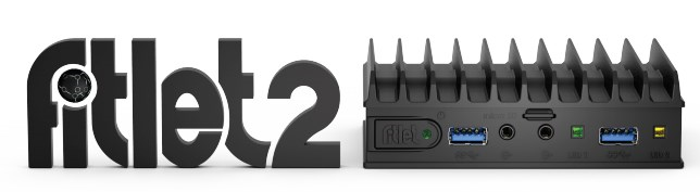

      I have pfSense running on a fitlet2 mini pc (Celeron J3455, 4GB mem, 64GB ssd, dual Intel NIC). Usual packages installed: pfBlockerNG, Snort and ntopng. Works fine, but in the last 2 weeks the device froze 3 times. In every case the power was still up, but both nic's (LAN and WAN) were frozen. The status lights were off and no traffic was passing. The GUI was not reachable. The only option to recover was to reboot the device. There is nothing in the systemlogs to go on. I searched the internet but can't find a similar case so far.
      Any idea what might be going on here?

        The intel i211 looks good, I mean it's perfect for pfSense
        Filet2 also looks good....
        pfSense with the igb (4) intel driver is very stable, so not the NIC freeze
        there is something more serious in the background that you can find out from the shell after you "freeze"
        you don't see anything from the GUI in the logs, because it doesn't work either "freeze"
        the shell is usually yes
