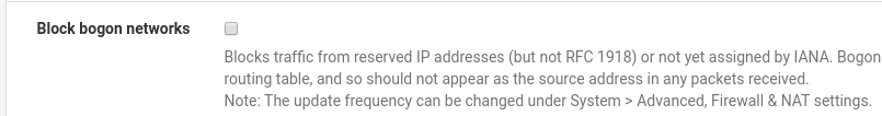

                          @GunerX Try to temporary disable "Block bogon networks":
                          and run /etc/rc.update_bogons.sh (without force) again
