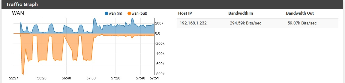

      Hello,
      I am using an sg-1100, to protect a small number of devices from an untrused LAN. The pfSense (v2.4.5-RELEASE-p1) on this device is running the basic services, plus DNS resolver, pfBlocker and SNORT. I've been having a few strange problems, (like config changes almost always being lost after I apply them) but another I am now noticing is that the sg-1100 is using a significant amount of bandwidth while it should be idle.
      While running with one idle PC (LAN port), one idle Raspberry Pi (LAN port), and one idle WiFi router with no connections (OPT port) on this box, I see both the LAN port:
      And the OPT port:OPT normal.jpg
      Consuming a reasonable amount of traffic. However, the entire time, the WAN port is moving a lot of data, non-stop:
      As I watched it for about an hour, I noticed two brief disruptions to this norm:
      But other than that, it remained constant. I first began investigating this because the LAN and OPT link lights have been staying mostly solid, but the WAN port's link light is always flashing rapidly.
      Does anyone have suggestions what is going on? Is there some justification for this? Or has it been compromised? It's more ingress than egress traffic, which is slightly less concerning that the opposite ratio, but it still doesn't seem right.
      To be clear, no one other than me uses this device, or connects into it from the LAN/OPT sides for any reason whatsoever.
      Thanks!

        @CyberMinion Change graph to remote and see...
        • stephenw10S Online
          What is that host: 192.168.1.232? The WAN IP?
          Check the state tables for what's open there.
          Run a packet capture, see what that traffic actually is.

            That is showing "All" but remote does not change the readout much in this case. This is behind a NAT, so 192.168.1.x is in this case the WAN subnet.
            Yes, that is the WAN IP of this pfSense firewall.

            Now that I've started poking at it, the issue has vanished, but I'm sure it will return. It did this to me once before as well. When I notice the issue and first start poking at it a little bit, it keeps going, but if I do much or start a bandwidth-intensive process on the LAN, this unexplained load suddenly vanishes. Not sure if this is on the up-and-up (just prioritizing user activity over whatever this is), or an IOC.

                    The resolution is bits/second in those graph screen grabs. So while not silent, the interfaces are not exactly maxed out either.
                    Correct, but 300Kb/s is still a lot of data for the pfSense to be downloading non-stop, while the other two ports are idle. Where is that data going? And where is the uploaded data coming from?

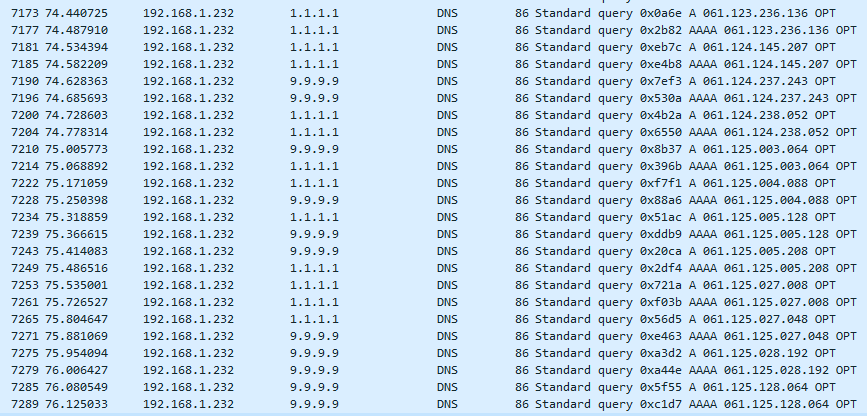

                        @stephenw10 I was preoccupied for a bit there, but I just noticed this going on again, and got a couple pcaps.
                        Here's the weird thing...virtually all of this traffic is between my DoH providers and the pfSense. It is mostly my backup DNS provider in this case (IBM) but I see a little bit of my primary provider (Cloudflare) in there. I'm not sure If I should go publishing the pcaps on here publicly, but do you want me to DM them to you?
