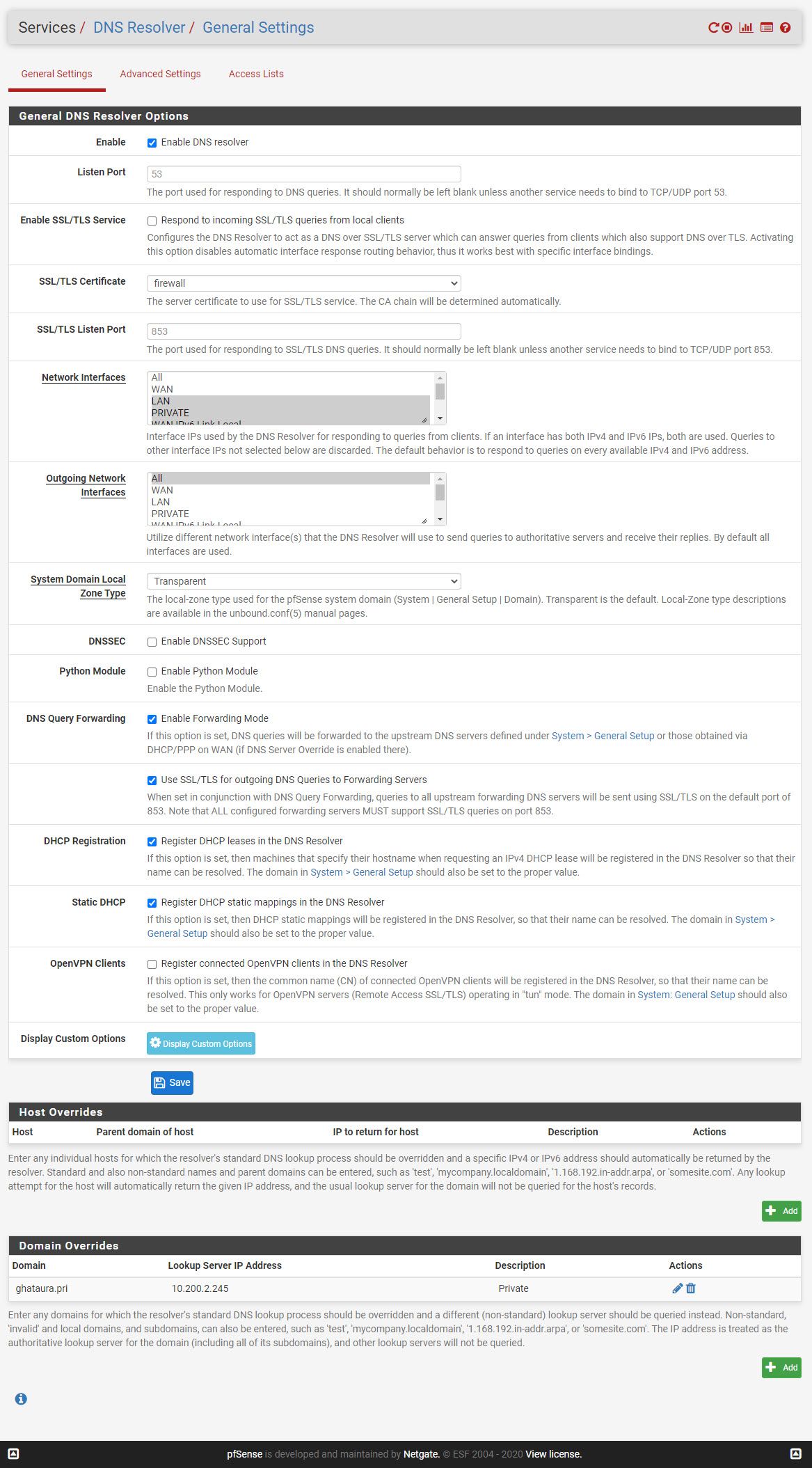

          sunnyg @DaddyGo
          @DaddyGo Here are the settings that I am using:

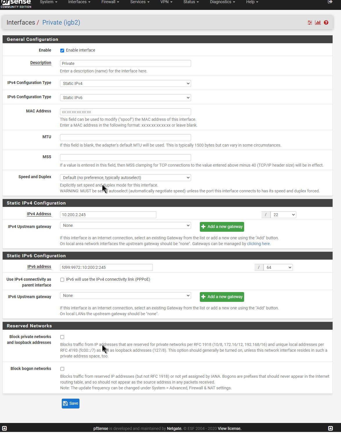

          Private network nic:

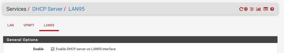

          DHCP Server settings for Private connection:

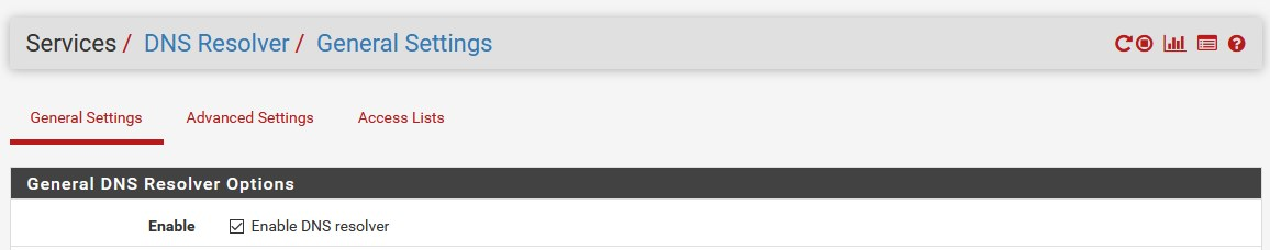

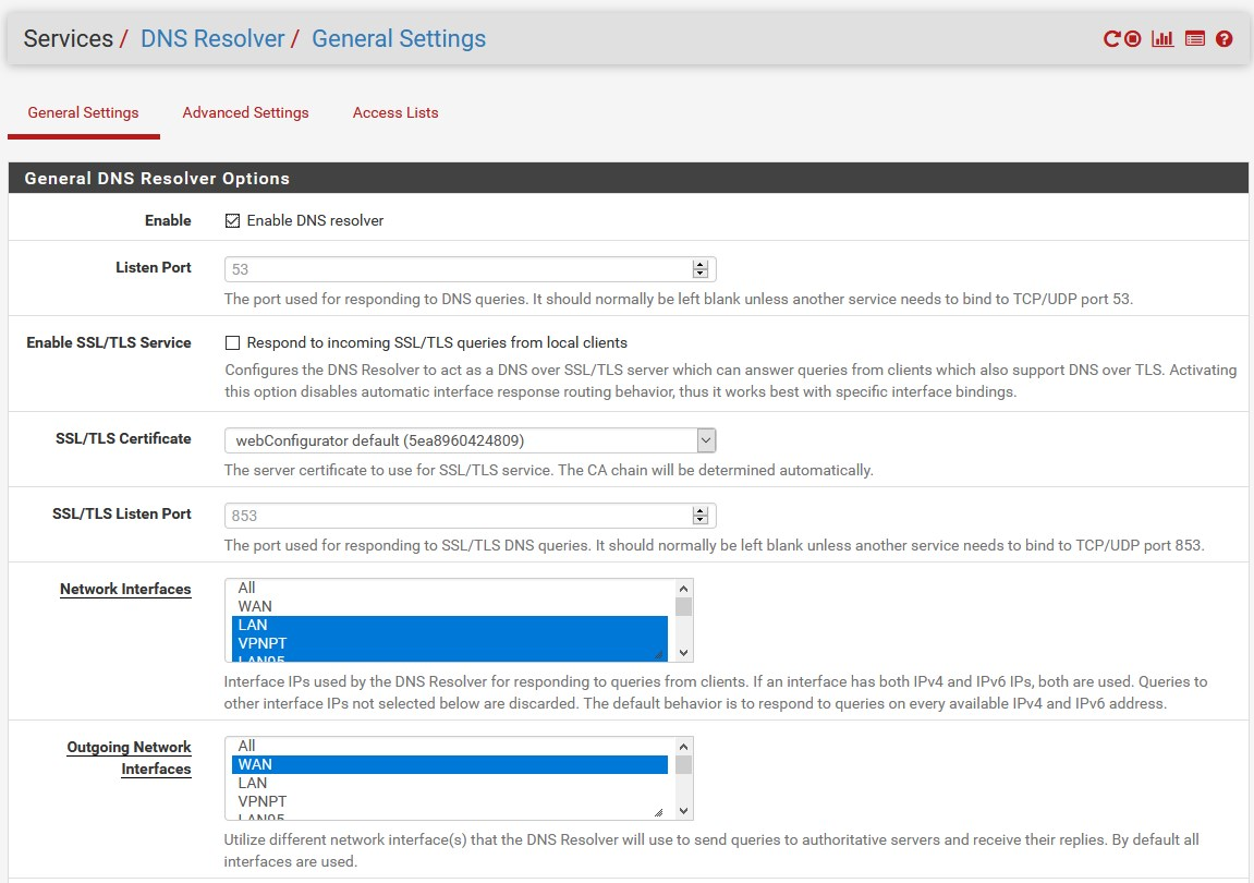

          DNS Resolver settings:

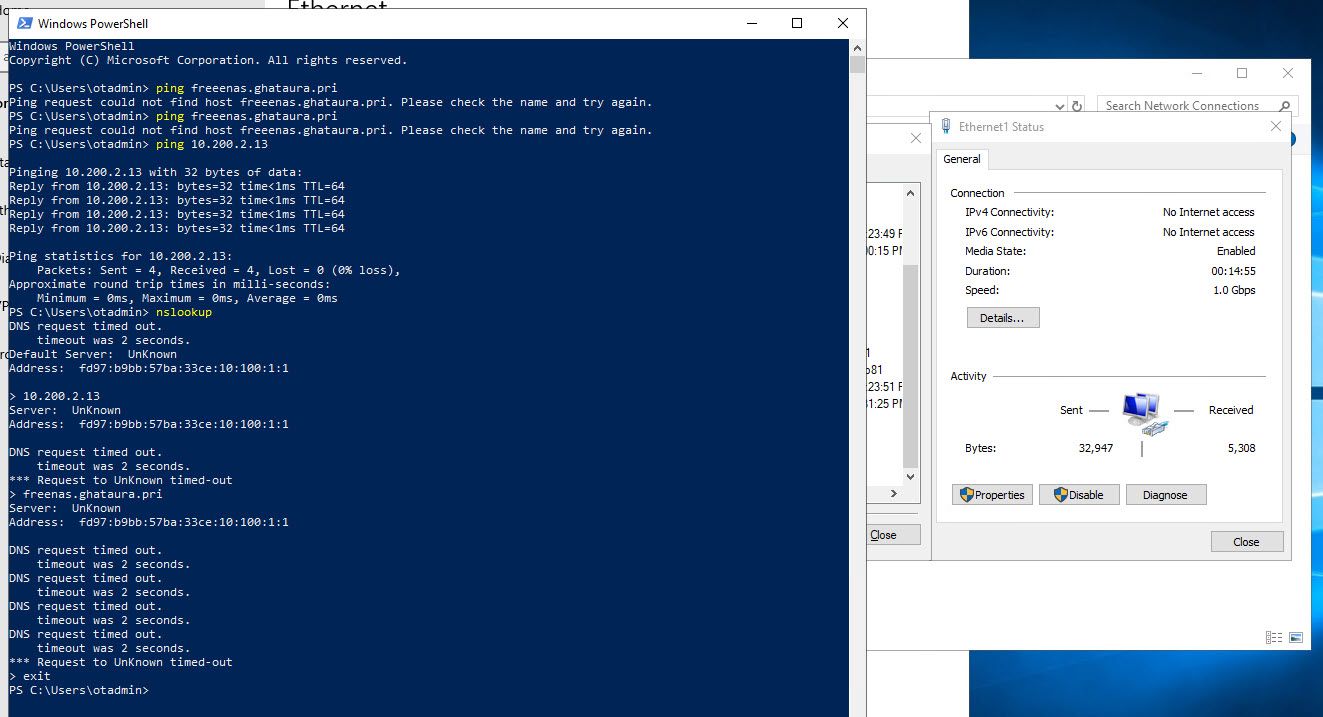

          Ping test on test system failing
          The client system gets a IPv4 address, DNS settings, and Gateway information, but the connection shows no internet (not worried about that), but the name resolution fails, although I can ping the system.

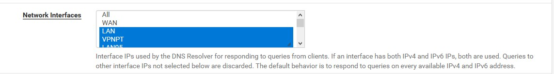

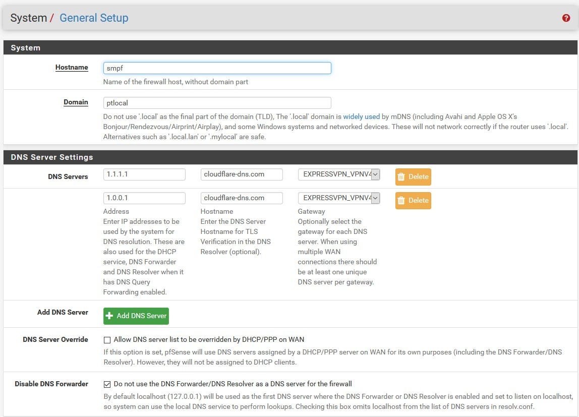

          • DaddyGoD Offline
            DaddyGo @sunnyg
            @sunnyg
            How big is this "PRIVATE" network?
            is it worth configuring a 10.xx ..... network with 255.255.252.0?

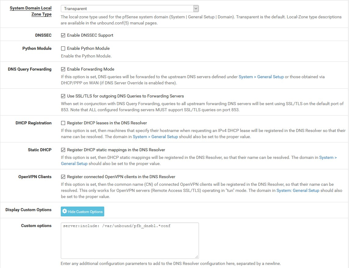

            I show the correct DNS settings (in my example with CF servers, DNSSEC, DoT 853)
            Resolver:
            General Setup:

              @DaddyGo Ok managed to get it working, i had Enable Static ARP entries enabled, which was preventing the DHCP issued systems from being able to communicate with pfsense.
              • DaddyGoD Offline
                DaddyGo @sunnyg
                @sunnyg said in How to configure pfsense as DNS server for 2nd LAN connection:
                Enable Static ARP
                Magic 😉
