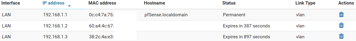

      There is no entry in the ARP table.

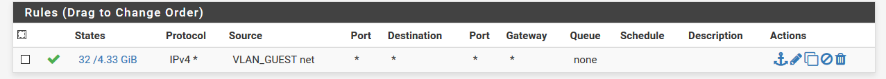

      I haven't configured any rules on these interfaces beyond Allow All rules like this:0ff35ca4-8083-4859-8c2f-1644a05dc21f-image.png

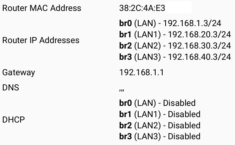

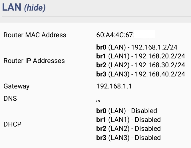

      AP 1:
      AP 2:

        Hmm looks like the APs can ping pfsense.
        I took turns plugging them in to ping 192.168.1.1
        Now I have an entry in the ARP table for both of them and pfsense can ping them.
        My desktop still can't ping them or access their web gui.
        I still can't have both of them connected at once, but I guess that's one problem solved?
