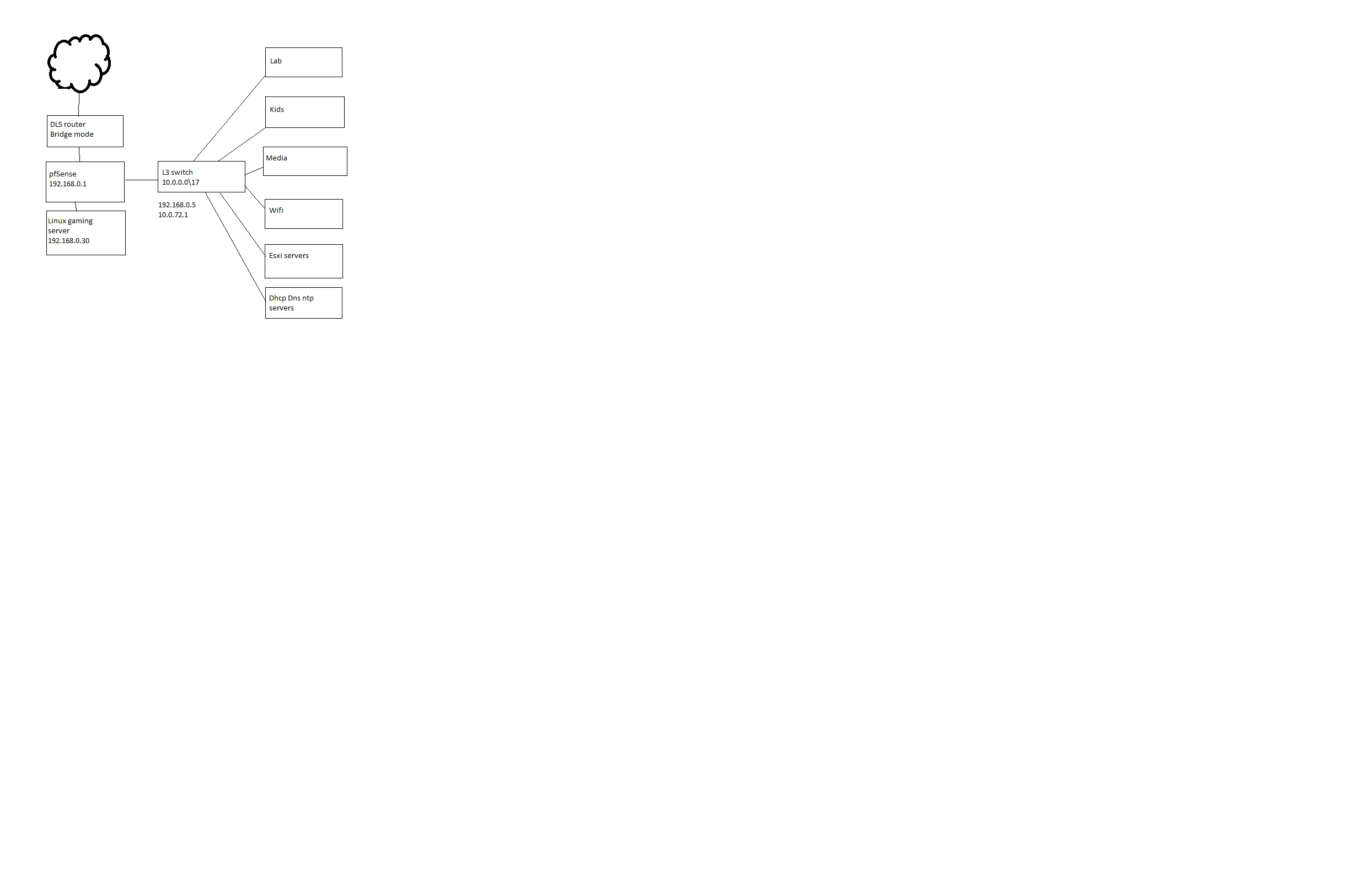

          • S
            Can we get a basic diagram of how these systems are connected?
            • F
              F1Fish

                • J
                  So your transit network is is this 192.168.0/24 ? You do not put hosts on a transit network.. This comes up like every day it seems..
                  And your trying to access the game server from some downstream network..
                  This is asymmetrical.. So no its not going to work without routes on the game server.
                  And take you don't even have default route on this game server, so it can not even send the syn,ack back??? Even with default route to 192.168.0.1 - pfsense would not allow it because it would be out of state.
                  You need a route on the gameserver saying hey to get to 10.0/17 talk to 192.168.0.5
                  F 1 Reply Last reply Sep 17, 2020, 1:24 PM Reply Quote 0

                          • F
                            F1Fish @johnpoz
                            @johnpoz
                            So your saying I should go with a router on a stick. Or move the game server tto a vlan routed by the switch. To clear up the asymmetrical network.
                            • J
                              You need to take your server off the transit network... Be it you want it to be a vlan hanging off your downstream router, or a vlan off of your edge router (pfsense)..
                              But currently that network is transit (a network between 2 routers) putting hosts on it that need to talk or get talked too from network via one of the routers lead to asymmetrical traffic flow.
                              Throw another vlan on your pfsense and put your game server there, now you can actually firewall between your downstream networks and the server..
