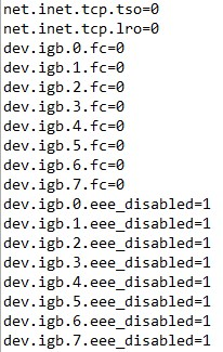

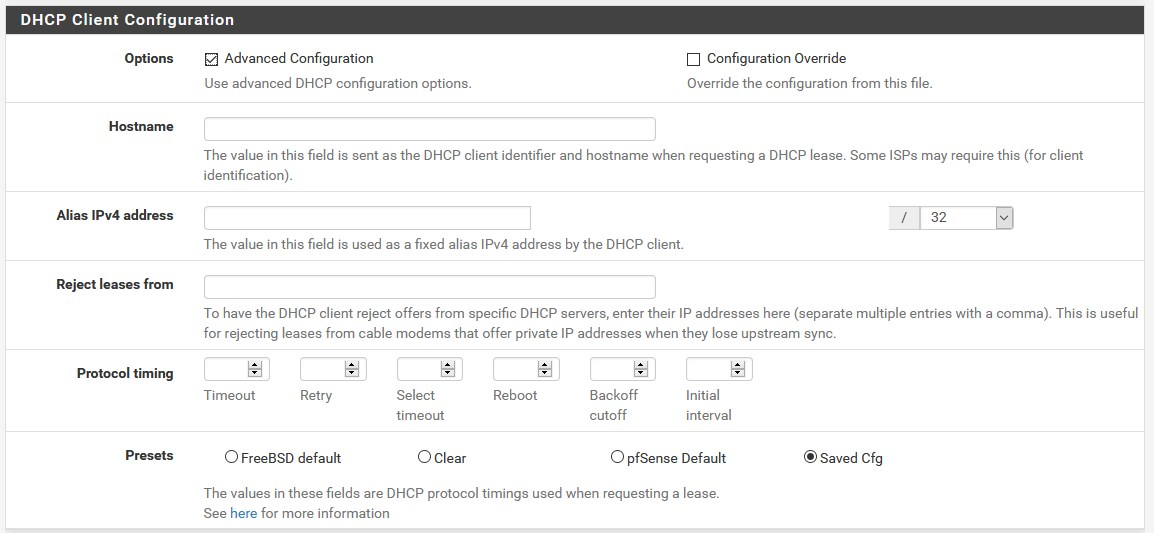

      • DaddyGoD
        DaddyGo @BlankSpace
        @BlankSpace said in WAN fails to keep DHCP address on cable modem reboot:
        pfs fails to keep the WAN dhcp address.
        This is an old theme with us, for some reason, this behavior is typical only of DOCSIS cable modems.
        We’ve talked a lot about this behavior here on the forum, it’s worth following it up and reading about it.
        Some special behavior with the CMTS and edgeQAM settings of DOCSIS systems and they affect users (subscribers), such as "Prerequisites for Cable DHCP Leasequery" / DHCP MAC Address Exclusion List / etc.
