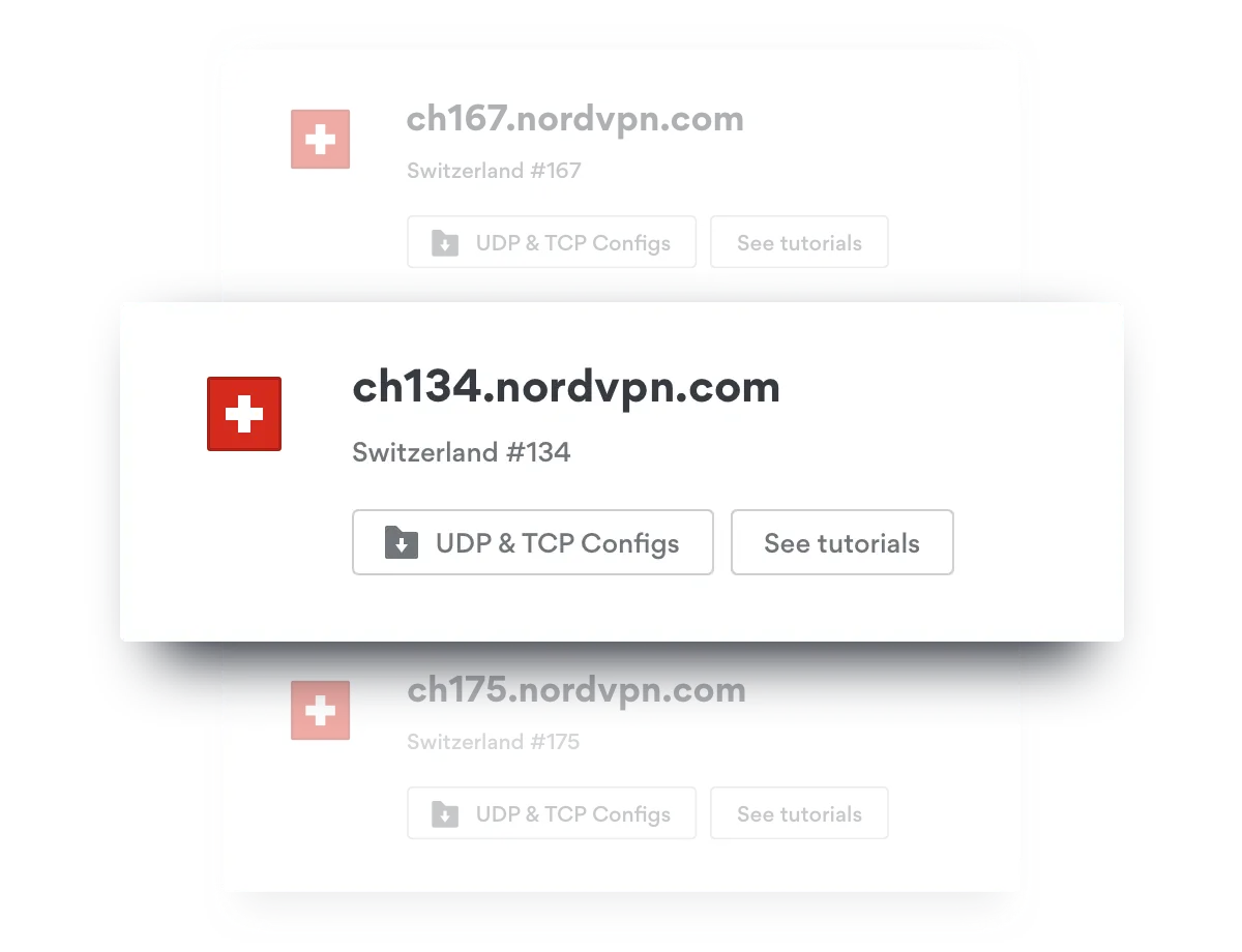

              VPN > Openvpn > Clients > Edit > Server host or Address
              Change it to different host from your VPN provider, with Nordvpn is a bit easier. Just change the digits ch 167 to ch 134. This way you don't have to change your TLS key.
              alt text
              @Steve, it's true but I did notice this trick worked, 6 out of 10 connections will use the same ip as monitoring ip.
