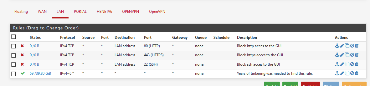

          Put these 4 rules on your LAN firewall :
          ( edit : have to wait - can't upload right now... )
          edit again :
          Note : if your LAN uses IPv6, use "IPv4+6" instead.
          Ports 21,80 and 443 could be grouped in an alias, so you can set up one firewall rule blocking these ports.

            @Gertjan Are these block rules (looking at the description - ie "Block SSH")? They look like allow rules.
            • stephenw10S Online
              Mmm, they are allow....
                Gertjan @ahking19
                @ahking19 said in Setup management interface on separate network:
                Nice catch.
                When making the image, I wouldn't lock myself out while doing so, so I edited the image - and finally posted the wrong one.
                Corrected.
