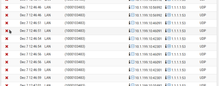

          However, everything checks out as far as the configuration goes. Looking at the firewall logs though, I'm getting basically everything coming from my LAN blocked:
          The rule it references doesn't seem to exist, and when I click for more info it says the rule that caused the block is " " without any more information.

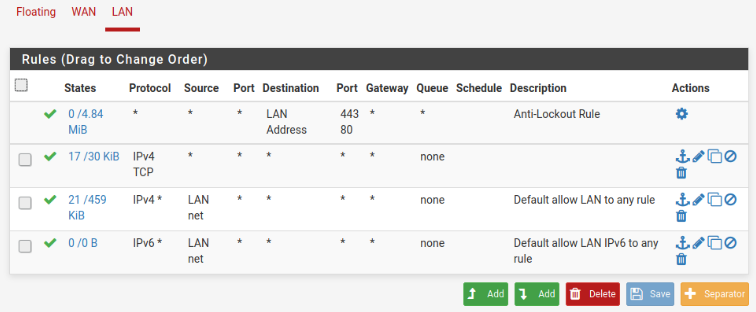

          I tried forcing an any/any outbound rule for LAN but this didn't seem to change things:

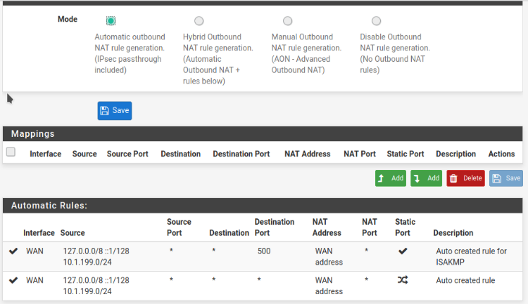

          And my NAT rules are all default and working since I can ping out from my clients:

            The Default allow LAN to any rule is fine, your custom rule is TCP only (not any/any) - delete that.

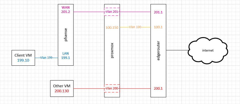

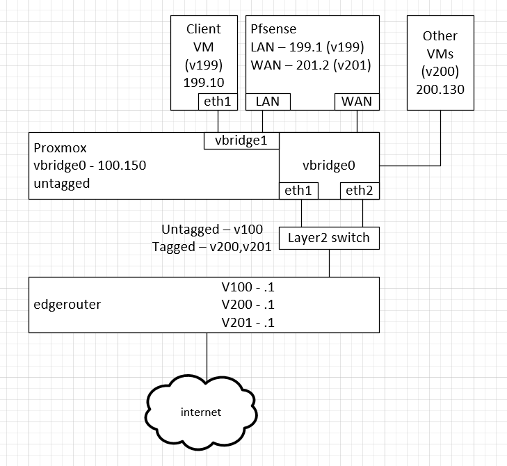

                      Can you draw how your stuff is connected together including IP/network addresses?
                      -Rico
                      • T Offline
                        theokonos @Rico
                        @rico So, here are a couple of illustrations. One is more proxmox-centric and the other is more topology-centric.
                        Basically, I have three gateway interfaces on my router: one for proxmox's management subnet (.100), one for my other normal VMs (.200), and one for a point-to-point link between my router and pfsense's WAN (.201).
                        Proxmox is enabled with two bridges; one that allows VMs to connect to my router directly (vbridge0), and one without any ports in it (just an empty virtual switch) that allow other VMs to connect to pfsense (vbridge1).
                        pfsense has its WAN on vbridge0 and its WAN on vbridge1.
                        In this topology, pfsense should be able to talk directly to my router's vlan 201 address as its upstream gateway. Then any VMs connecting to pfsense would connect to vbridge1 on vlan 199. (I'm doing all of my VLAN tagging actually on the individual VM interfaces, not in the OS or pfsense config.)
                        Here is an illustration of the bridges and the system architecture:
                        And here is one that's more straightforward regarding the network topology:
                        (all IPs are 10.1.x.x)
