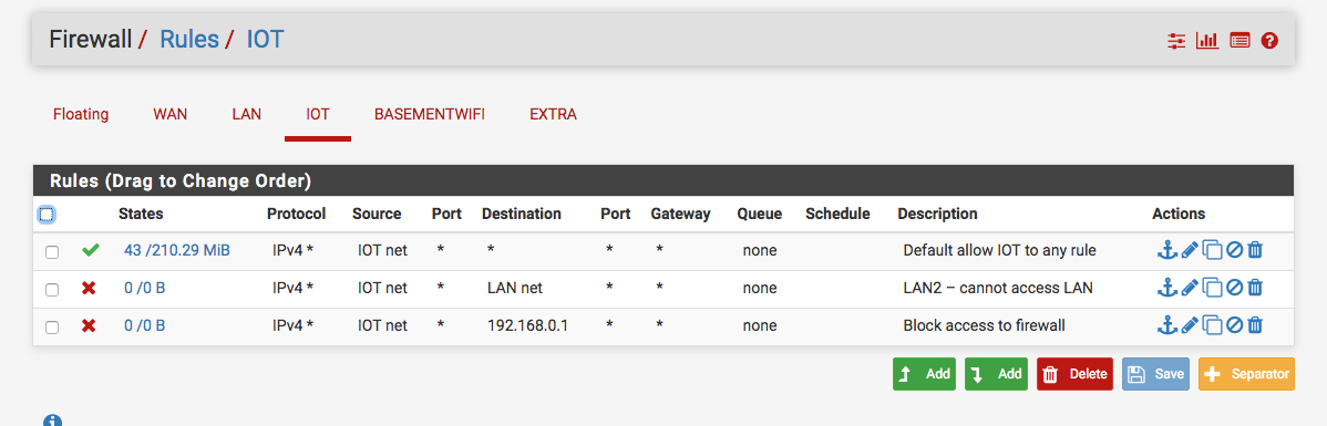

      I have setup two Block rules on the Firewall for both LAN2 and LAN3 not to (a) have access to LAN1 devices and (b) not have access to the firewall web page.
      All works fine but for some reason both LAN2 and LAN3 can access pfSense web page on 192.168.0.1 even though their subnets are totally different.
      How can correct this and ensure that all 3 LANs remain separate? Any help would be appreciated!

            @viragomann Thanks for your quick reply. The 192.168.0.1 is on the LAN1 So I setup the following Floating rule:
            and for the separate LANs have the following rules:
            Do these seem right?

                              Keep in mind that just because you create a block rule doesn't mean there isn't an existing state that is allowing the traffic.
                              When you go to block something - you need to make sure there is no existing state that is allowing.
                              The "this firewall" is the best way to block access to the firewall for vlans you don't want to be able to access stuff on the firewall you don't want.. because it also includes the wan IP which is quite often public. So would not be included in any rfc1918 alias you use..
                              Here is a example set of rules for a locked down vlan..
                              Can be modified for your wants/needs. It allows this vlan to ping pfsense IP on that vlan - for connectivity testing. It allows access to dns and ntp.. But then all other access to any other vlan or any firewall IP is rejected. Rejected can help with letting the client know - you ain't getting there... So no need to keep trying via retrans, etc. This can be helpful on local networks - would never do on wan.
                              Then it allows everything else, ie the internet.
