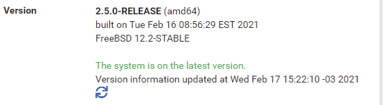

      Just upgraded from 2.4.5-p1 to 2.5.0 release. Realtek NIC (re) is not recognised anymore. No issues with Intels (em) NICs.
      Installed from ISO, same problem.
      Just a bit of warning for all (re) out there...

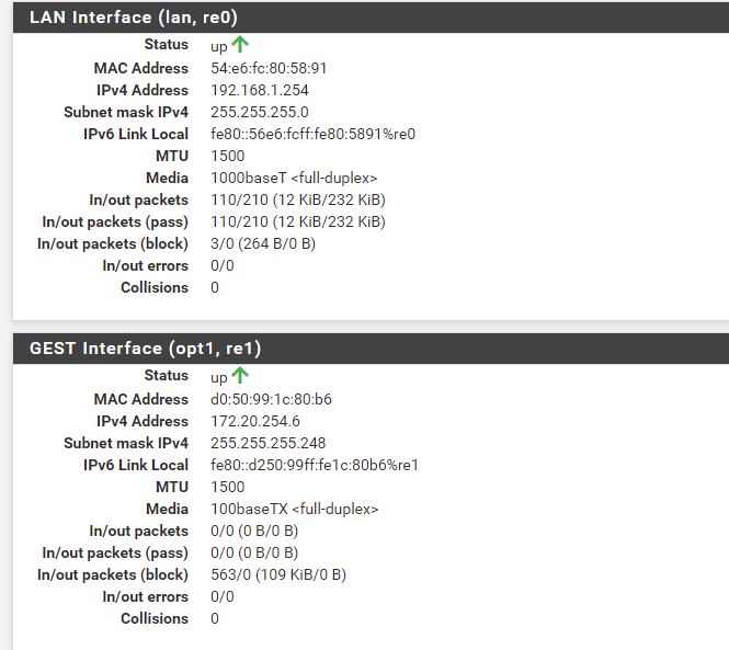

          This is Realtek NIC (the 2nd listed) not recognised:

              Thanks for your immediate feedback. Some more troubleshooting required here...

                    Just for common reference, installing from scratch, using .iso just downloaded, formatting (zfs) the target system, RealTek NIC is not found. Following your tip the card is now recognised and working.
                    • jimpJ Offline
                      That card must not be supported by the stock FreeBSD driver then. The one from the package repository is newer and from Realtek itself and not from FreeBSD.
