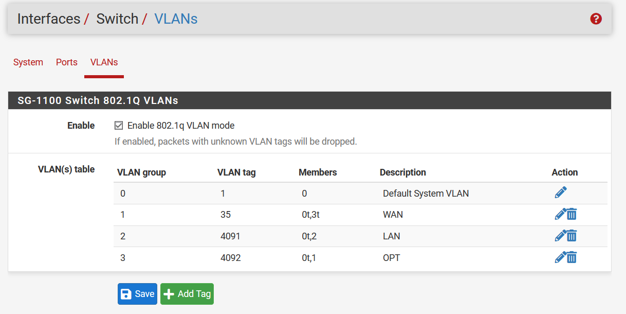

      Now, (I don't know if this is relevant information), I noticed that if I go into "Switches VLAN" and disable "802.1q VLAN mode", then two things happen:
      1. I loose the web interface (I cannot connect to it anymore) and somehow my laptop cannot get an IP anymore.
      2. If I check the Netgate console, WAN now has an IP which seems correct.

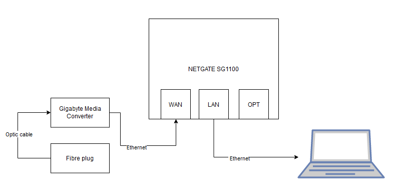

        @xaad I should have added a diagram of the setup
        Eventually, I would like to plug the LAN into my switch but first I'd like to get internet working as simply as possible.

          @xaad I finally found a way to make it working by also changing the Switch VLAN that was originally 4090 (0t,3) to 35 (0t, 3t).
          I really don't know if this is the right way since I could not find any other post describing this as necessary.
